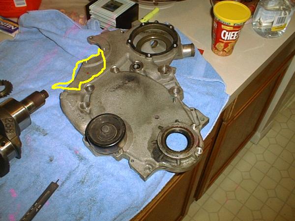

    OK, so, now I'm thinking more and more about the FWD timing cover.
    PS not an issue, I can get a S10 manual box and be done with that. more room for turbo headers...
    BUT, what needs to be modded on the FWD timing cover so that it clears the upper intake when it's facing the "wrong" way ?
    Anyone done this before ?

      I think the PS "bracket support" on the timing cover is what becomes the concern...... If you plan on going manual, you could just slice that portion off and call it a good day..... Don't forget though, that the belt routing WILL need to be addressed since the PS or a PS delete pulley is there to make the routing of the belt doable... So an additional idler or few might be needed to allow for the lack of PS pulley.

                As I came back in to grab the camera, I remembered taking the t-stat housing off to get the LIM to fit. since the RWD timing cover needs to be notched to clear the LIM, I just spun it around since I just needed to see if the turbos could squeeze in there. I also opted to use the s10 steering box and nix the PS in favor of A/C

                  Forced, what am I looking at here ^ ?
                  Is that the RWD timing cover or FWD ?
                  Not much room there at all...

                    #24
                    If one were to try to cut the yellow section out...
                    Would leave some meat for an idler pulley to turn the water pump, AND allow the thermostat housing to be there...

                        #26
                        no go on the FWD timing cover.. right where the LIM T stat neck would be is a coolant passage. You would have to cut through that, weld both sides shut and run a hose around..
