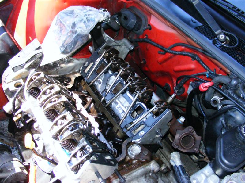

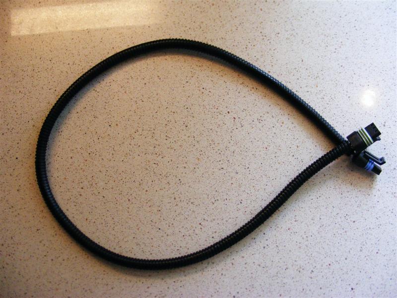

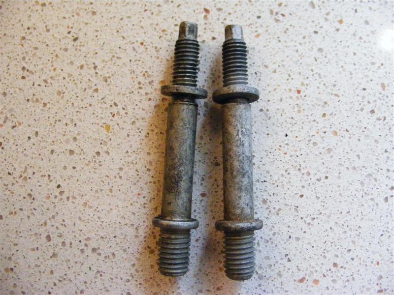

    If ya haven't guessed I'm re-assembling from the heads on up my 1997 3100. As for these bolts I know one of this type bolt goes on the head to support the dip-stick. Where do the others like this bolt go? Also, here's a 2 foot long wrapped wire connector with different females at each end and it lays between the lower block and the backside exhaust downpipe. I can see a wire loom clamp at this location on the transmission where this wire used to go. What will these electrical ends go to upon re-assembly.

    I think the bolts are for the ICM, and the wire, if twisted, sounds like it could go between the 7x crank sensor and the ICM.

          Yes, yes, yes. The stud/bolts are screwed into the top of the head at the exhaust ports on the rear bank to support the ICM bracket. If you line up the ICM bracket with it's upper holes on the intake you will see which two holes the studs go in above the exhaust ports.

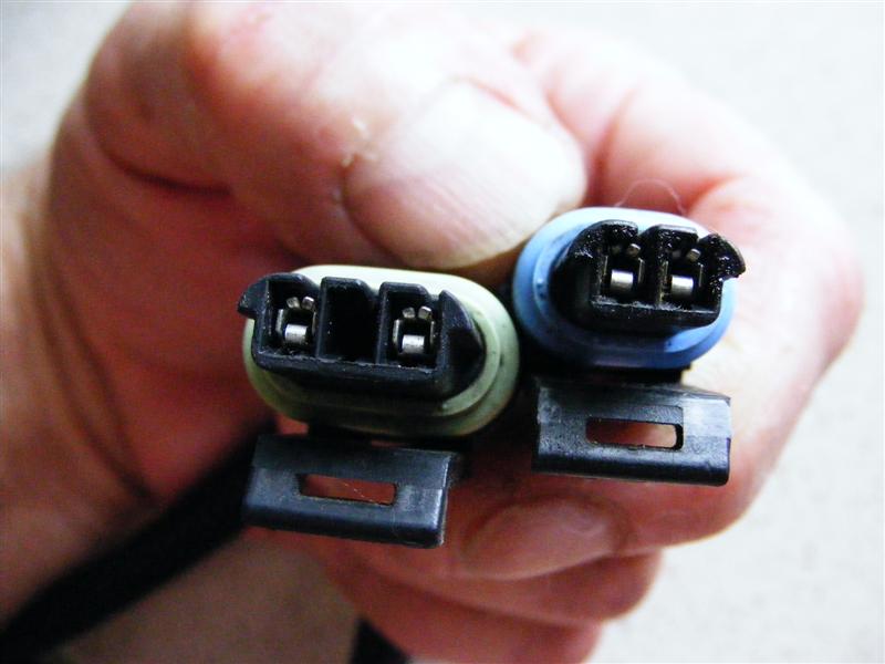

                  Well, that's the only wire I can think of that has a 3-pin connector on one end and a 2-pin connector on the other.

                    I'm with Brad on this one and have never seen a 2p/3p wire for anything except the CPS (on the rear of the block) to ICM. Are three connectors already plugged into the ICM? The CPS to ICM cable has two twisted wires in it that are usually purple and yellow. What are the wire colors in that one?
                    MinusOne - 3100 - 4T60E
                    '79 MGB - LZ9 - T5
                    http://www.tcemotorsports.com
                      It is the CPS sensor wire. It's a 2 pin at the block sensor and a three pin at the ICM.
                      There is only ONE wire on these motors that has a connector at each end and not part of a sensor, or the wiring harness, or injector harness.

                          I will say it again, the two pin plugs into the crank sensor on the back of the block, not to the harness. This is a sensor to ICM connection it does not plug into the engine harness.
