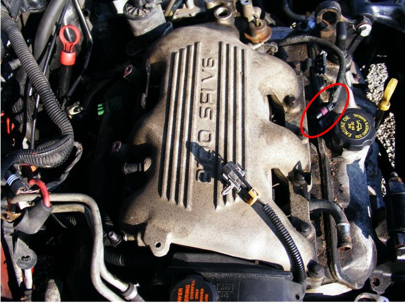

    Where would this wire go?
    I did find some disassembly pictures but i can not find this connector with the Lavender rubber grommet. Any help indentifying would be great.........Tom

    What wire color/s?
      if i didn't know any better, i would say it's the connector for the dash temp guage... but that's at least a 96.... i thought when OBD2 came into effect, those went away.

        Originally posted by 86FieroSEv6 View Post
        What wire color/s?
        That's what i'm saying 86. I'm going back UP with this motor and i can't locate this connector i have circled
        • 86FieroSEv6
          • Feb 2010
          • 527
          Wellllll, it looks like the temp sensor wire and usually comes off of the injector harness at the throttle end of the manifold then goes down the front of the engine to the sensor on the water outlet extension of the LIM.

            Dude you nailed it.......Have'nt reassembled that far yet......Thanks.......Tom
