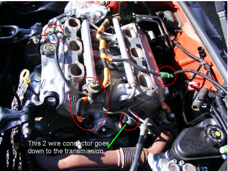

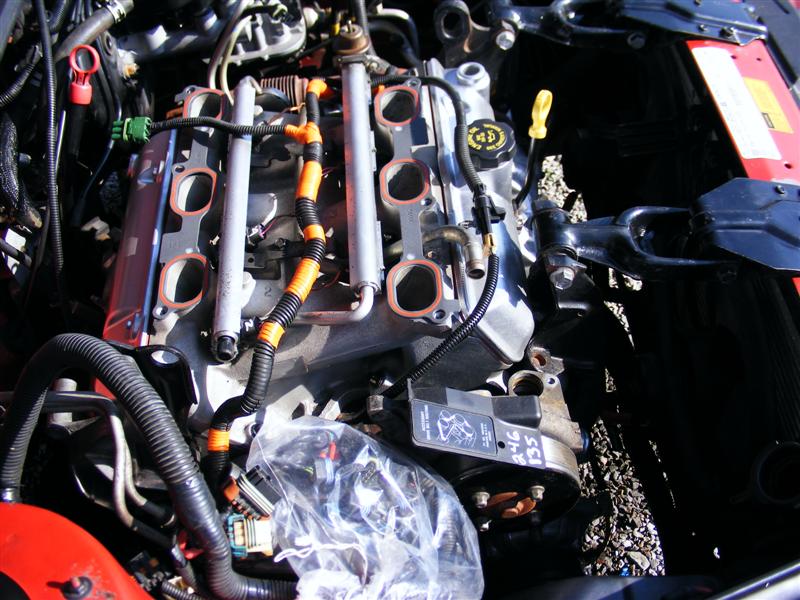

    Before installing the top manifold I'll ask, "do my electrical leads look routed correctly"?.
    Anything look out of place please let me know.........Tom

    Looks good to me.

      MAP sensor cable might need to go under the fuel rail and UIM gasket.

        See the injector harness? Should the harness be under the 2 fuel rail supports brackets or above the brackets?
        When i sit the uim on the lower it does not seat completely, but if i press down firmly it will seat. That's because the uim is riding on the injector harness.......Tom
