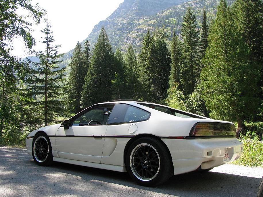

          Mine weighs 2650 without me. It has a 2002 3400 with a 5 speed manual.

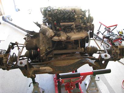

            I think that is a misconception. I have worked on many cars/trucks and even some boats and motorcycles. I find my Fiero very easy to work on. There was actually quite a few ingenius little engineering tricks GM used on those cars. Considering the budget they had for the car I think it is actually really well built.
            I use a gantry lift I built from old pallet racks (cheap), I can have the whole driveline out in a couple hours, it just drops out the bottom on a motorcycle lift, exhust, tranny, rear suspension, the whole bit. And for a mid-engine sports car they are really quite practical, good milage (32MPG with the 3400) descent size trunk (for mid-engine) cheap to maintain (Many parts interchange with other GM). I wasn't a Fiero fan until I owned one, now they impress me. I am even more amazed at what kind of power and performance you can get out of them for your money. Mildly modded 3800sc cars are doing 10-11 sec. quarter miles. Many Fieros have been tuned to pull over 1G of cornering grip. I still can't understand why these cars still get such a bad rap.

                3-4 yrs. ago, I talked to a guy that was a Fiero enthusiast. He got his mechanic to work on his, made it sound like a real pain to take out engine. But after seeing your setup, it seems like a nice project to work on. I've always been courious about them. I still remember people riding in them way back in highschool.
