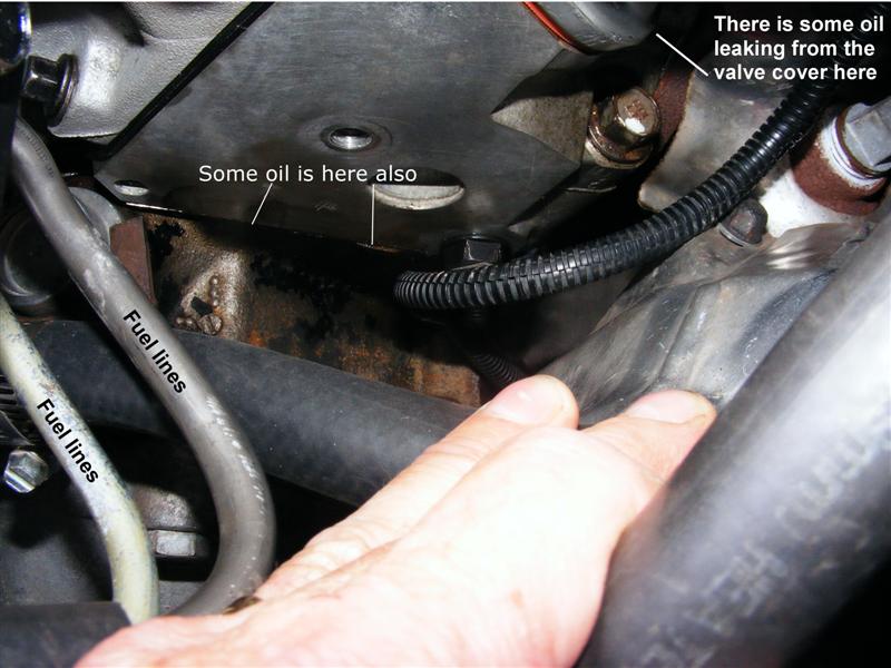

    It's been 900 miles since the topside 3400 parts to a 3100 upgrade and i've got a small oil leak at the rear, backside valve cover with also a little oil at the rear head, backside, head gasket area. What'a ya all think.......Tom

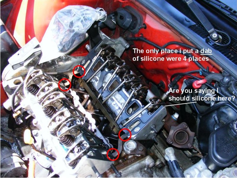

    Did you put a dab of RTV in the "V" notch where the valve cover, LIM and cylinder head meet?
    • fastback4
      • Feb 2009
      • 175
      Are you saying i should have put silicone here?...See pic.......TOM
      • 86FieroSEv6
        • Feb 2010
        • 527
        Just a little dab will do ya. Yeah, I've been stung by this leak before. Also, make sure to replace the breather/pcv grommets with Delco parts to help seal things up.
