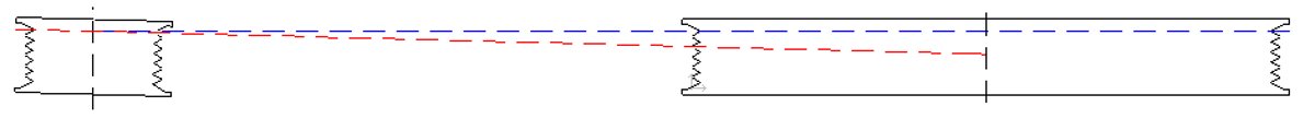

        My main concern right now is belt alignment. I figured I would get it somewhat close when I build the mounting bracket then find a way to make it adjustable to "fine tune" things once mounted.
        Do you guys have any suggestions on getting proper belt alignment? Right now I'm just working with a strait edge and a level.

          I use a 24" steel scale and a dial caliper for finding proper pulley location. I start by placing the scale on the crank pulley and measuring the the center of the first serpentine groove and comparing that to the location of the pulley that is being mounted. I repeat the process by placing the scale on the front of the new pulley to verify that it is square with the centerline of the crank. You can also measure to other pulleys that are known to be in the correct location.

            There is also this: http://www.easylaser.com/Belt%20Alignment.htm
            But somebody would probably accuse you of cheating, so by all means do it the hard way . . . . . . LOL (just kidding, of course). Don't forget that there is a certain amount of normal shaft end play on P/S pumps, so be sure to average the location to minimize thrust wear to the pump. A pretty good bit of alignment can be handled by pressing or pulling the pulley/hub in or out on the shaft (special tool requirement).
