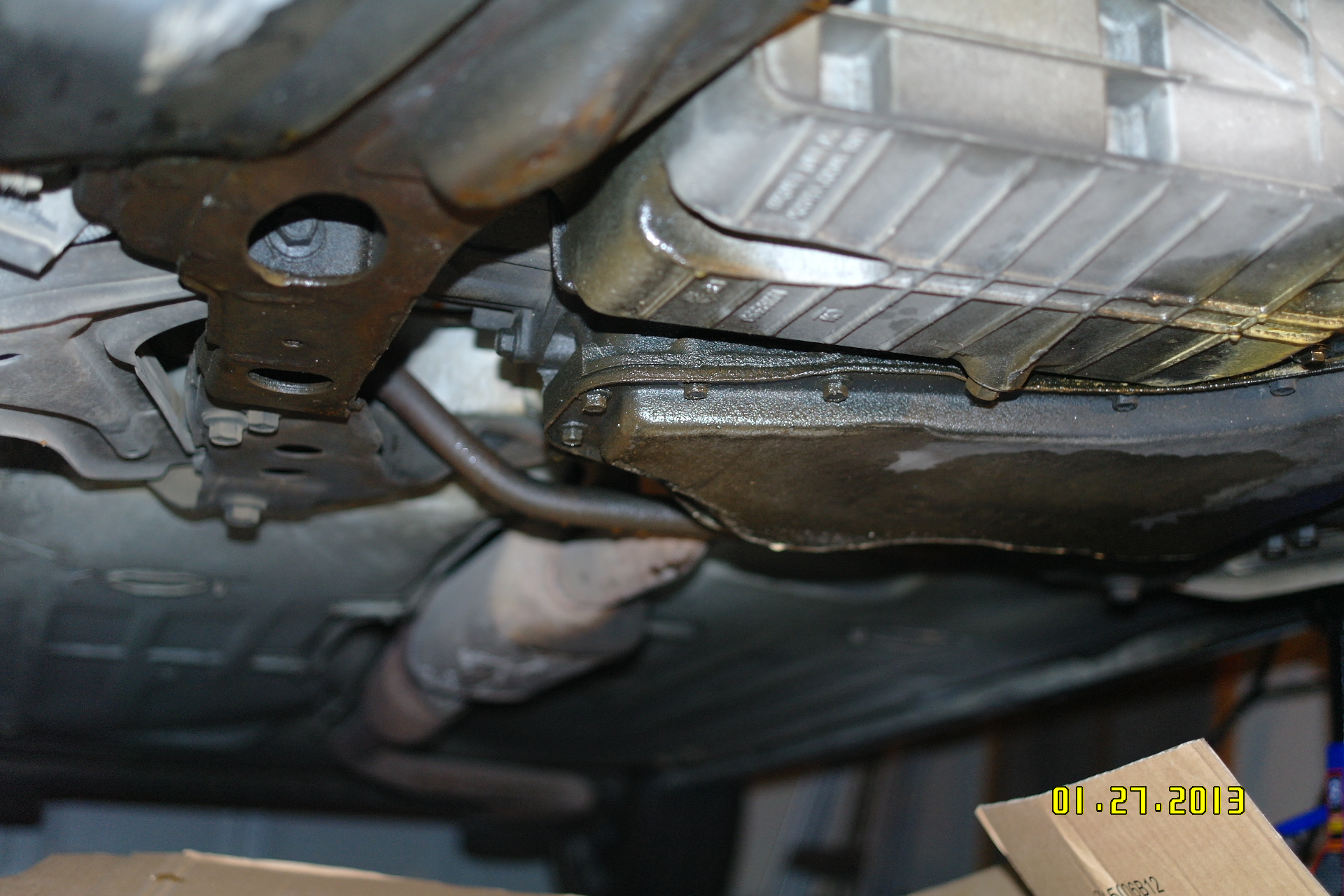

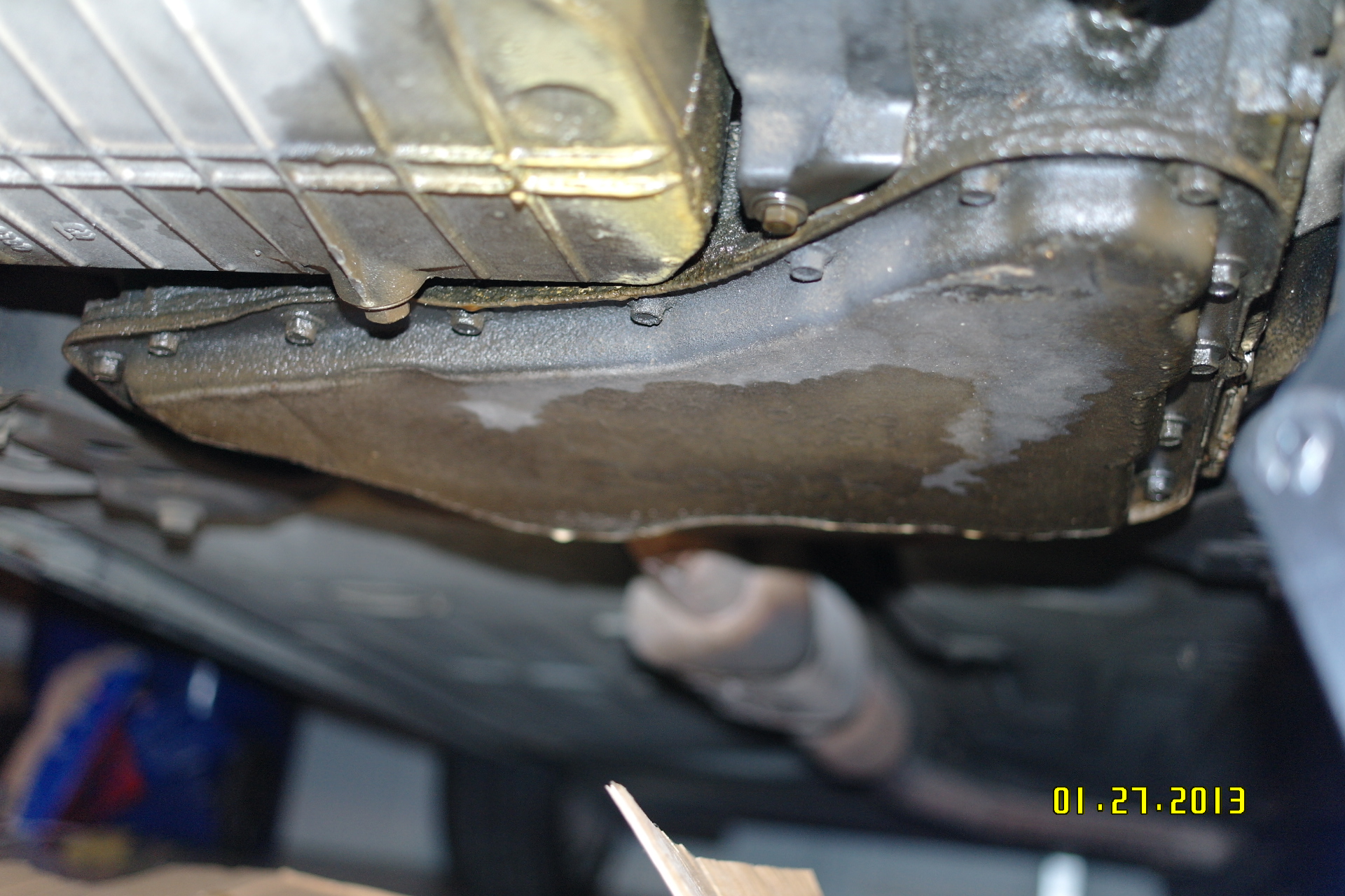

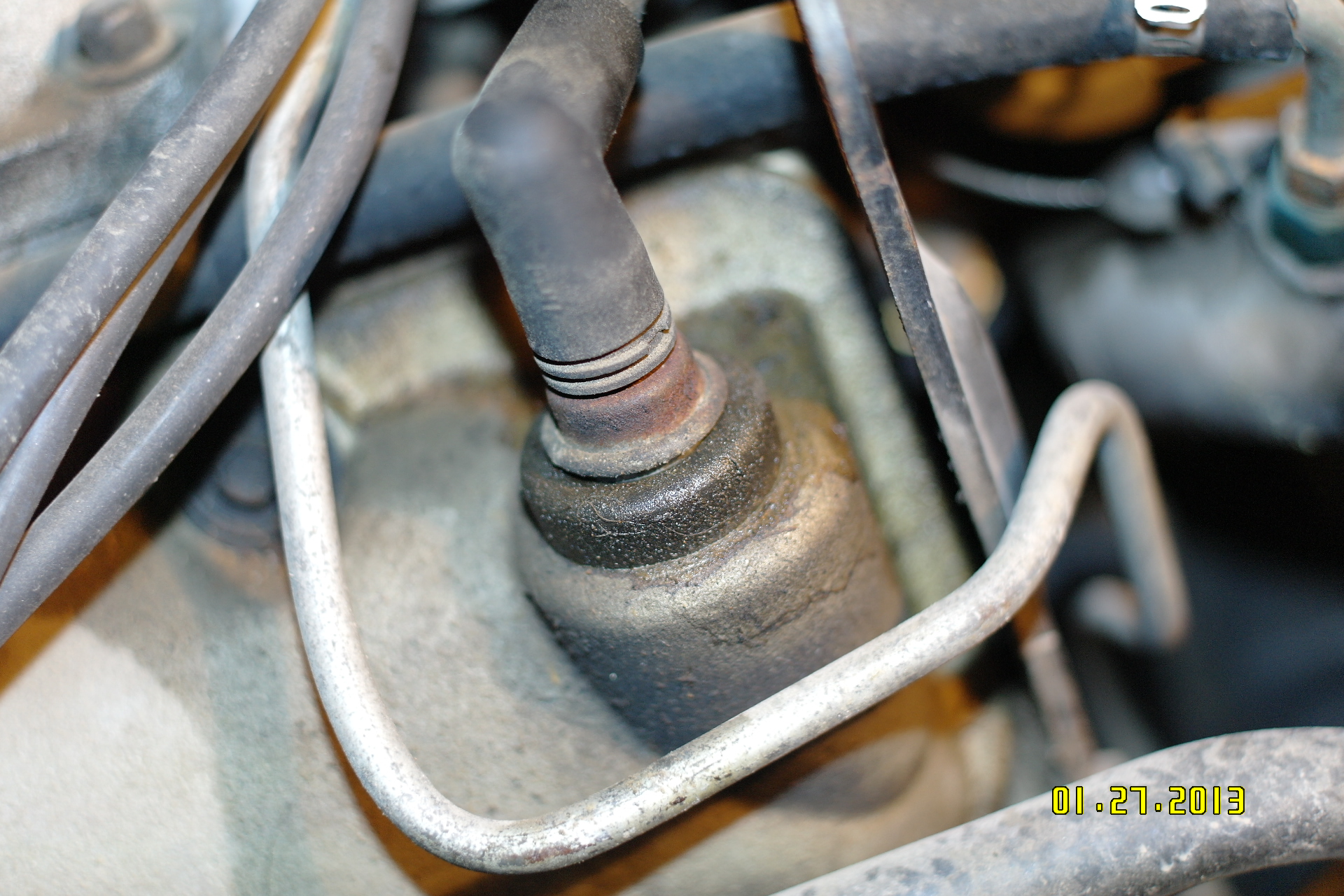

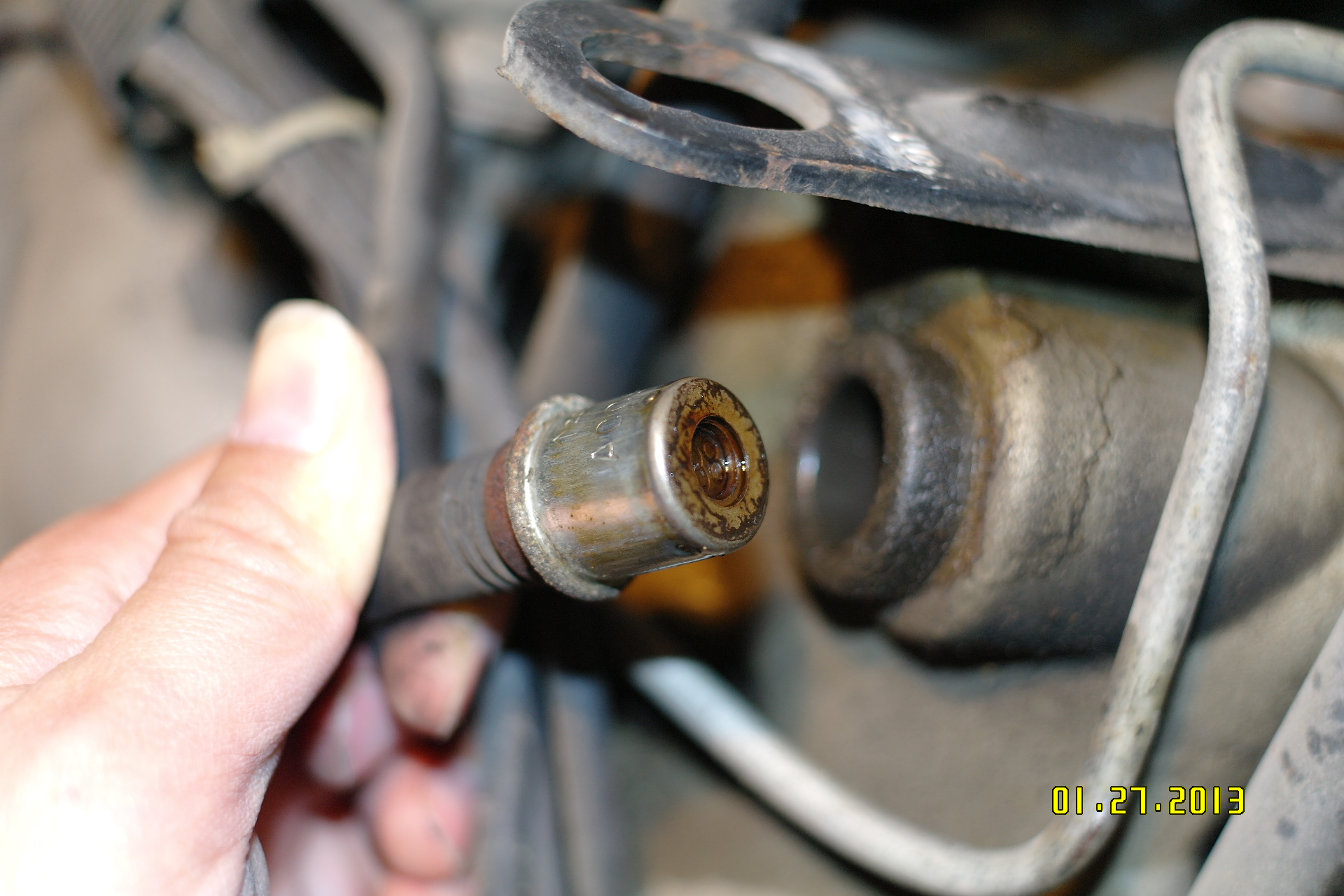

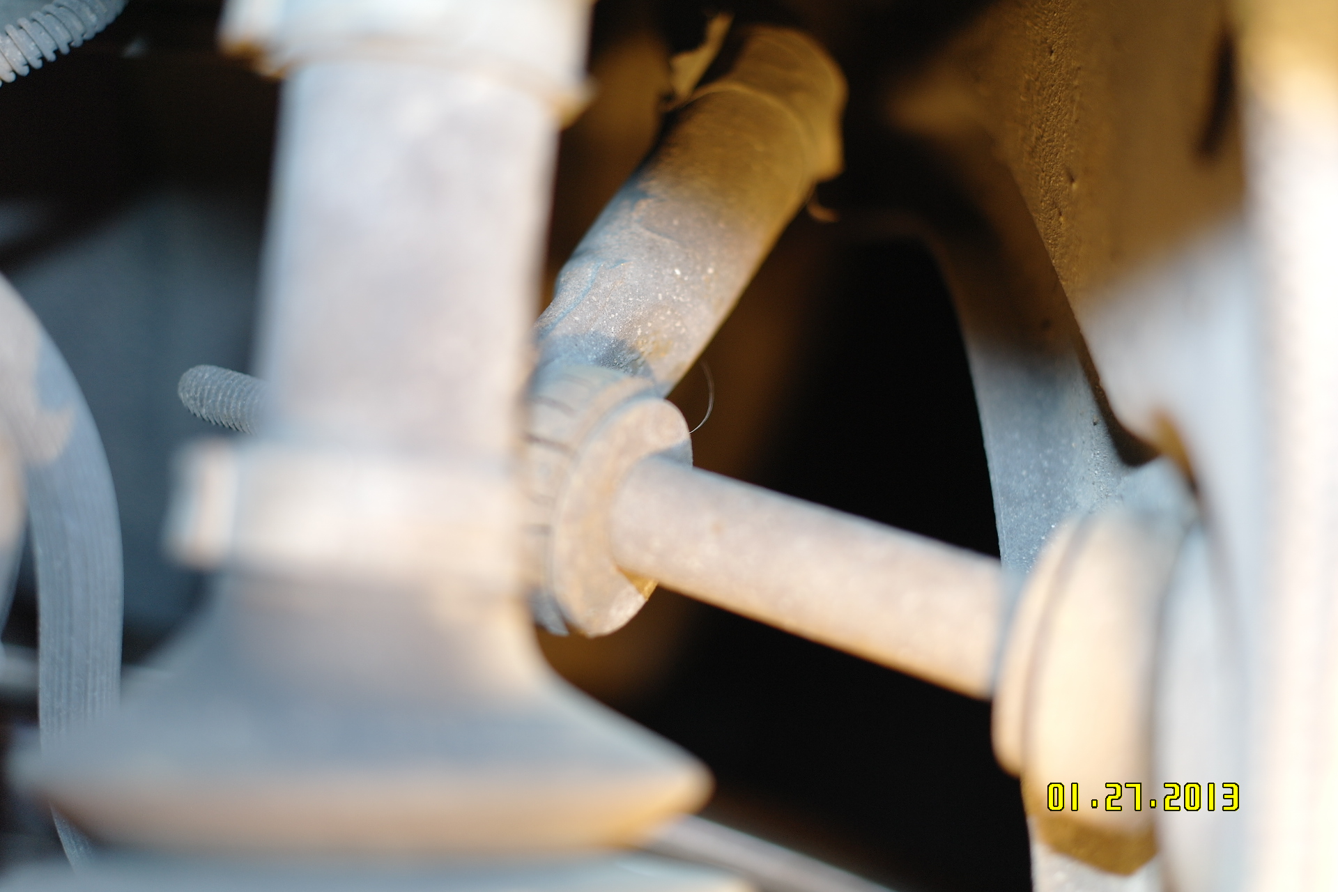

    Just got this car with lots of problems. It leaks coolant, power steering fluid and maybe battery fluid too. I posted some photos of the coolant and oil. Can you tell if it got into the engine? Also I saw the rubber bushings are worn out. Are they easy to fix? Thanks!

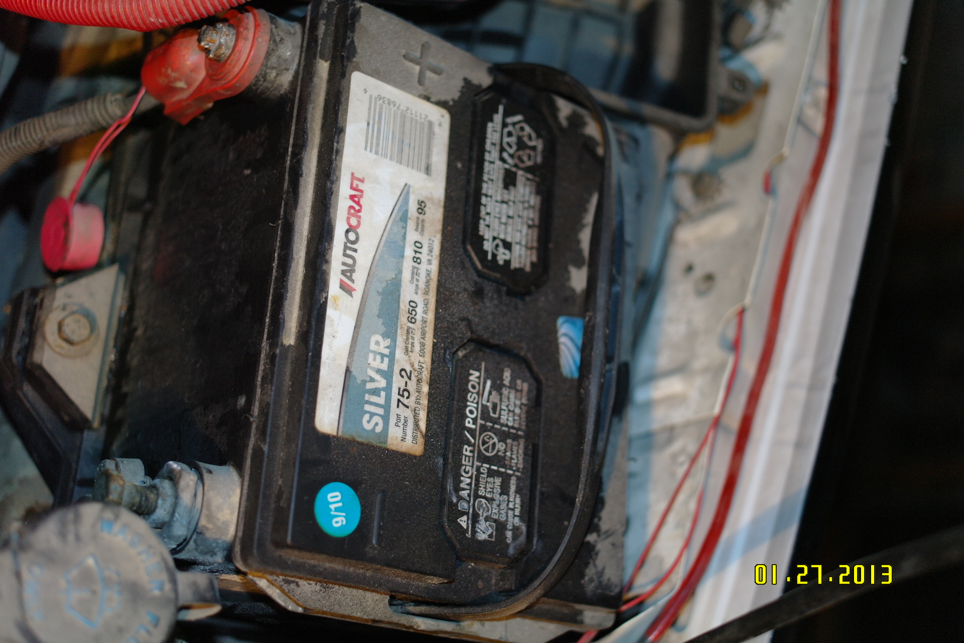

    Battery Leaks?

    2&3 are nothing to worry about. PCV gasket is a little old, but it's not dripping.
    Oil pan is fine, but yes there is something leaking on the trans(it's coming from the engine).

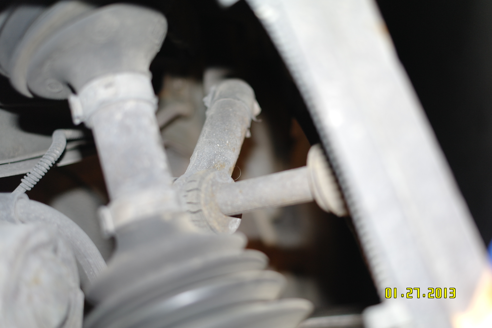

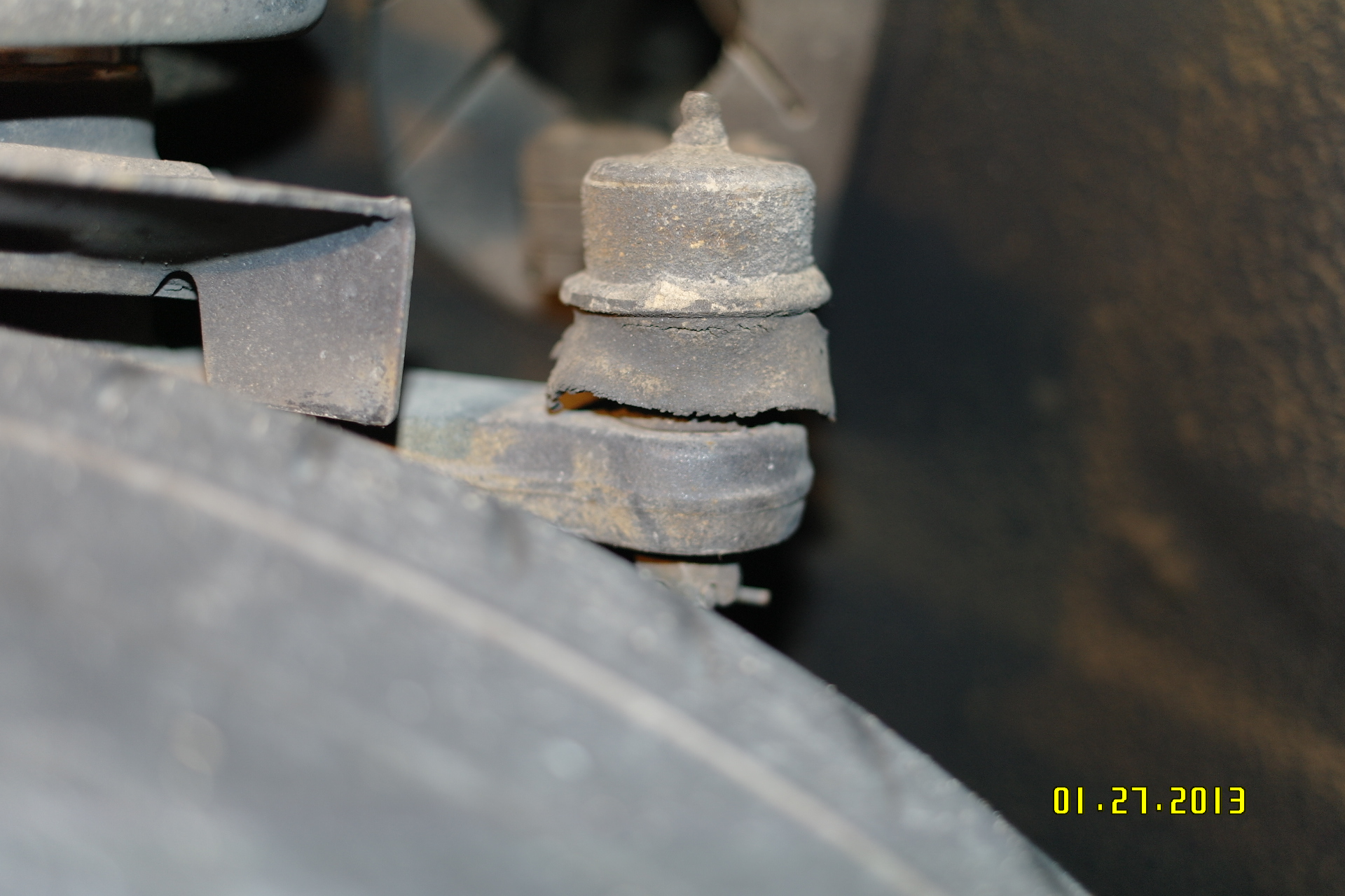

    5&6 are cracked sway bar end link bushings
    Tie rod end's dust cover is trashed in #8.
    Batterys do that from time to time. If it stays like that it's fine, but if it gets worse replace it ASAP.

      End links are very easy to fix. Just replace the tie rod ends, there is going to be too much dirt in them and they will soon be junk.
      If the oil looks like a milk shake then you have coolant in it. Did you check the sides of the heads like I asked you to? Just look at where the lower intake and the head meet. If you see coolant drips or dried coolant(dirty streaks) then it's time for new lower intake gaskets.

        ^^ what he said. If there is coolant in the oil, I'd do an engine swap with a 3400... From picture #4 looks like your LIM (lower intake manifold) gaskets are leaking or the quick connect for the heater core is leaking. But it's hard to tell without the whole car being here.. Your trans pan looks like it's seeping, but nothing I'd be too concerned with. Make sure the fluid level is full/top it off if needs be. If you care to fix the transmission pan gasket leak, buy a transmission filter kit and do them both at the same time.
        I'd also recommend steam cleaning the engine compartment and spray off the battery while you're there.
        • stargaazer7467
          • Nov 2012
          • 46
          clean your battery, that is a voltage draw and will slowly drain the battery. Dont beleive? Go get a volt meter and neg to neg and pos to filth, bet you pull 2-6 volts out of the filth....
