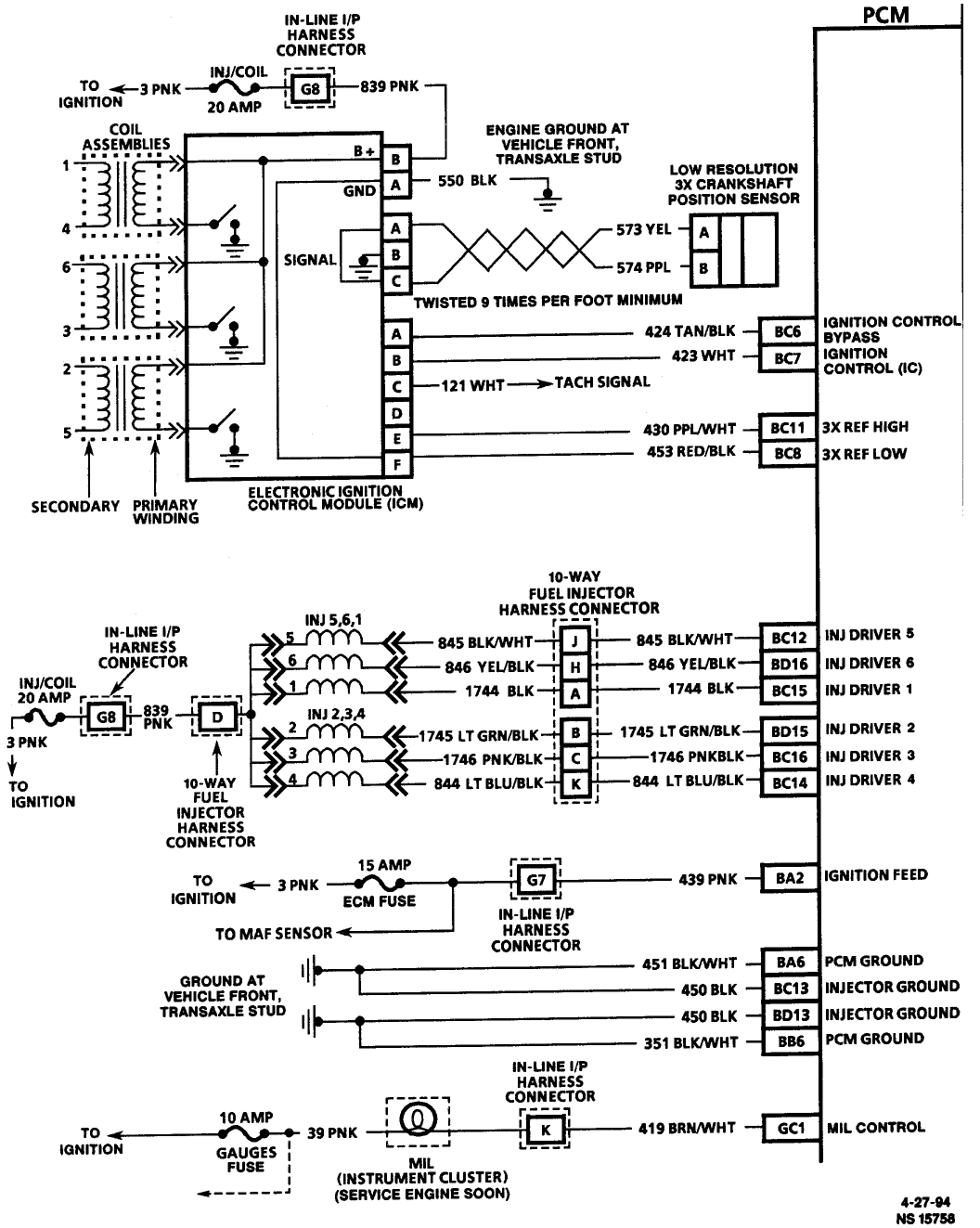

    hey i got an 03' Buck Century and it did not come with a tachometer factory. I bought a small under dash type digital tach (cyberdyne) but do not know how to hook it up. The century has the 3100. thanks guys

      White wire on the ICM should do it.

        yeah i thought about the regal cluster AFTER i bought the digital one would look cleaner but o well.... thanks ffirebird for the quick response will do this weekend
ID:	377553 lol just found this thanks
