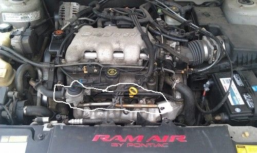

    2000 alero, 3.4 liter motor had 180000 and blew a head gasket, got a motor from a 03 grand am said 100 percent bolt up, changed head gasket and ever other gasket on the way up still overheating, my question is on the new motor the evap system is not the dual lines coming off each side of the motor like the original alero so that is not hooked up. car runs fine but is still overheating could the evap not being operational do this or do i need to look elsewhere? added a picture with it circled so you could see what i was talking about.
    thanks guys Click image for larger version

        Evap system will not hinder the cooling system.
