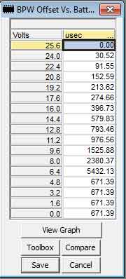

                    Attached is the BPW vs Battery Voltage offset table from one of my 3500 tunes. I think it's pretty much the stock 3.1 values, they always seemed to work well enough in most cases.

                      On most of the swaps guys are using the standard return type fuel systems (a majority of the chips I sell are for J and L body cars upgrading from 2.8/3.1 MPFI engines). It's easier to use a 3400 fuel rail and injectors. They have a good spray pattern and are good for 250 HP or a little more.
                      Ah, that makes sense. Since I was starting from scratch with the MGB, returnless using the stock injectors & rails seemed easiest.
                      Thanks for sending that "BPW" chart over - very interesting. Can you confirm the P/N on the injectors you're referencing? Mine say "12586557" & I've been unable to find any data on the web about them.
                      In Megasquirt (at least the version I'm using), I can only enter a 'base' dead time value for 13.2V, and a delta V value. Your data is pretty linear in the range of 11-16V, so this should work OK (assuming we're actually talking about the same injectors).

                        The table he sent you is what he uses for 3400 injectors. I don't think you'll be able to find lag times specifically for the 3500 injectors so your best bet is to start with that data and then start adjusting to see what makes a difference. With my 550cc injectors which are the same style as 3500 injectors (USCAR style), I found that the lag times were longer than earlier multec style injectors.
                        So to start off I would try adjusting the value to a bit longer than what's in the table above. Keep adjusting until you notice a difference. If it makes the problem worse, adjust to shorter times instead.
