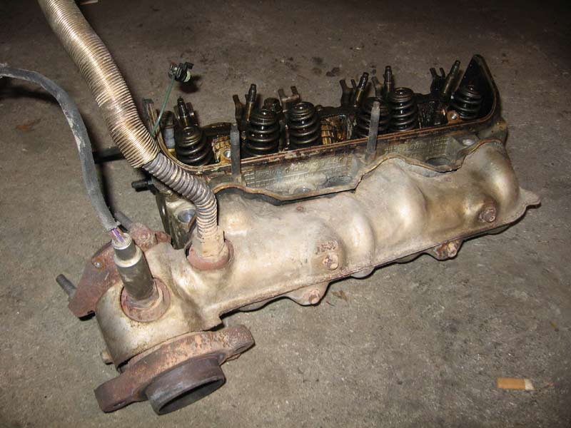

    91 3.1L - where is the o2 sensor located? Can someone take a picture and/or measure/guesstimate the length from exhaust port to the sensor? Thanks!

    its on the rear exhaust manifold. its maybe 8" from the cylinder head, maybe less.

      Its not a 3.1 but here is a photo of a 3100 manifold. Its in a similar location. Hope it helps

        Interesting.... on the 3.4DOHC, was it placed in the crossover? One of these engines had it in the crossover, I remember seeing it.

          Its in the outlet of the rear manifold on all the pushrod motors. It is basically considered the crossover because the front manifold feds into the rear one.
