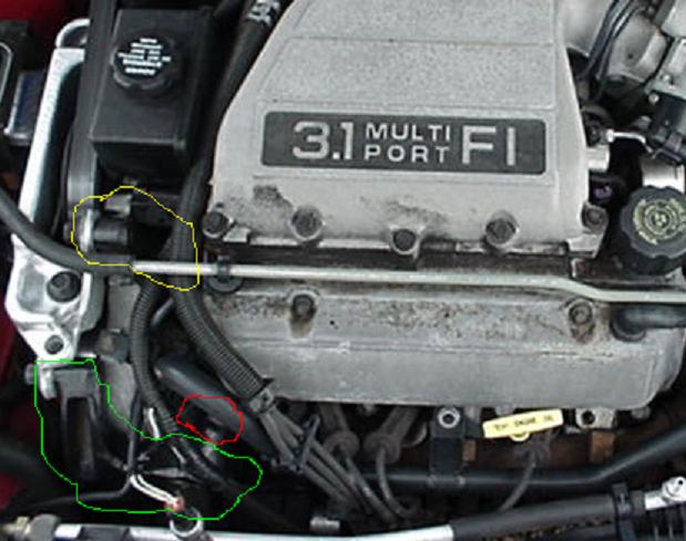

          no it is a the bracket that goes from the aluminum bracket on the side of the engine with the belt. it connects the aluminim bracket to the block. but a part of the bracket goes to the lower left bolt on the front head (if you are looking at the car from the front).the bracket is thick cast, so i would imagine that the conection from the aluminum bracket and the to points on the block will hold just fine. plus there is another bracket that connects the side of the head to the aluminum bracket, which has the aluminum piece that connest to the motor mount bolted to it. (the upper motor mount)

                the red is were i cut, the green is the bracket, the yellow is the other bracket i mentioned that will also provide more strenght. i know its kinda hard to see but if you know the engine youll understand. keep in mind grand prix's and luminas don't use these brackets.

                    it looks like the ac bracket was cut.

                      it bolts to the block behind the a/c bracket. the a/c bracket is seperate.

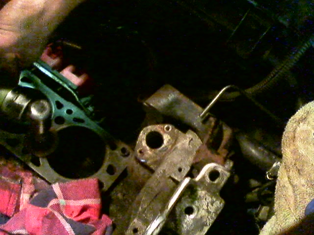

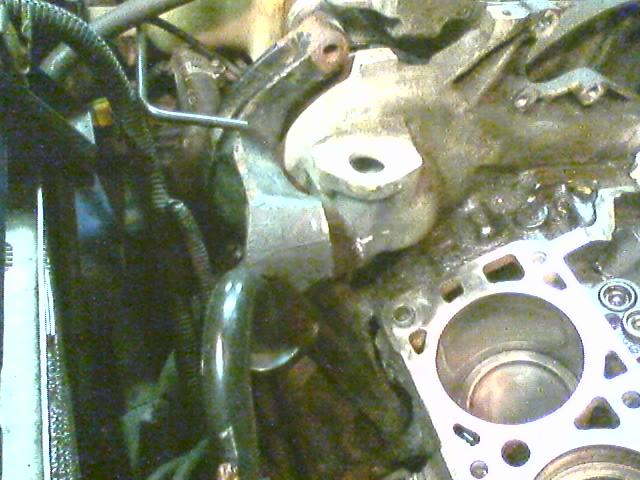

                        here are the actual pics of the bracket.
