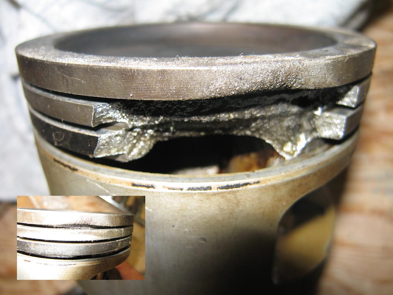

    remember the damage may not seem as obvious as if you pulled the piston. the side walls/skirt could be damaged aswell.
    check out this pic. the side of the piston was actually still on there, being held by the block. as soon as i pulled it out i noticed this. and from the top view while still in the engine i could see something similar to what u saw.
    check the pic. this was a ticking timebomb.just saying your damage may be more extensive than it seems, and if the piston explodes i think you kiss your head good-bye.

        Judging by farmerz24's pictures it looks like I should definitely check the pistons for hidden damage.
