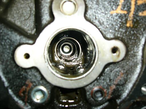

    Alright, well, it worked in case anyone wanted to try.
    I however had to remove the UIM to get the oil pump drive out.
    But so far, my LIM gaskets are still in there 100%, and my cam is out sitting on the bench.
    Now the hard part will be not dropping the new pushords down past the lifter when I install them... should be fun.
