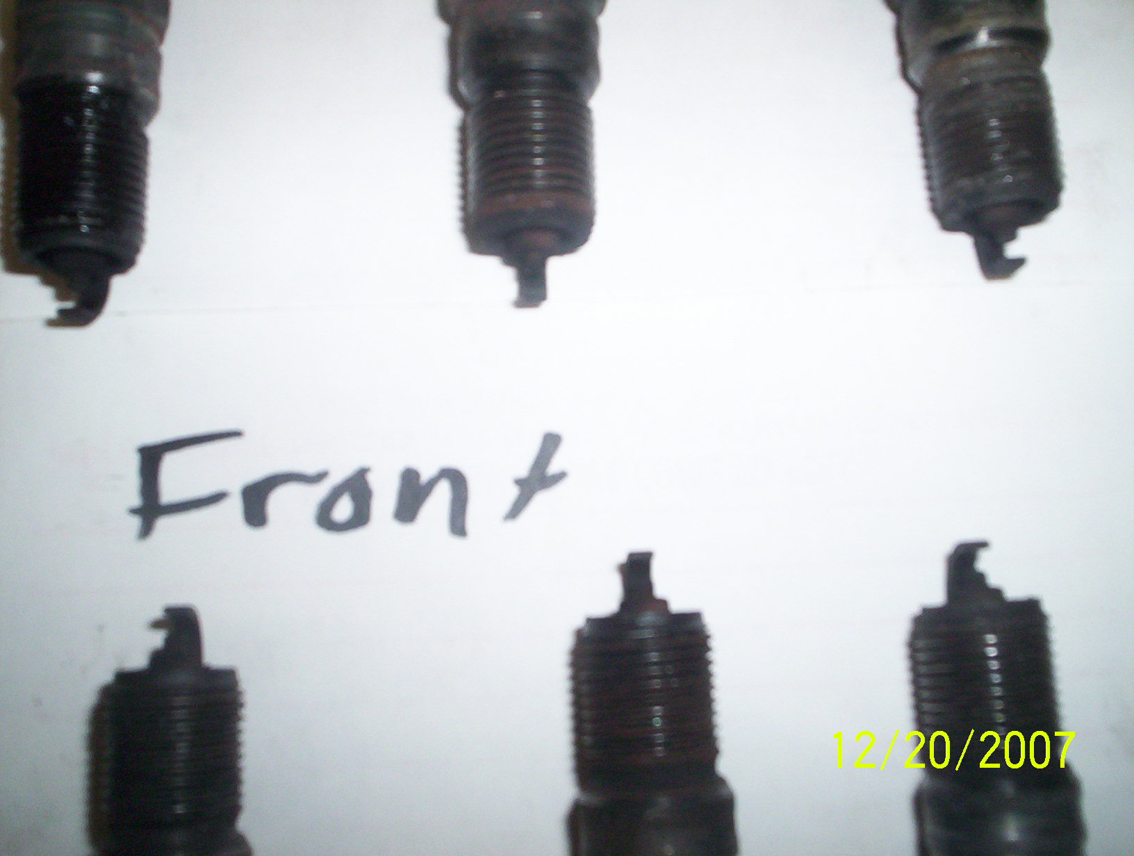

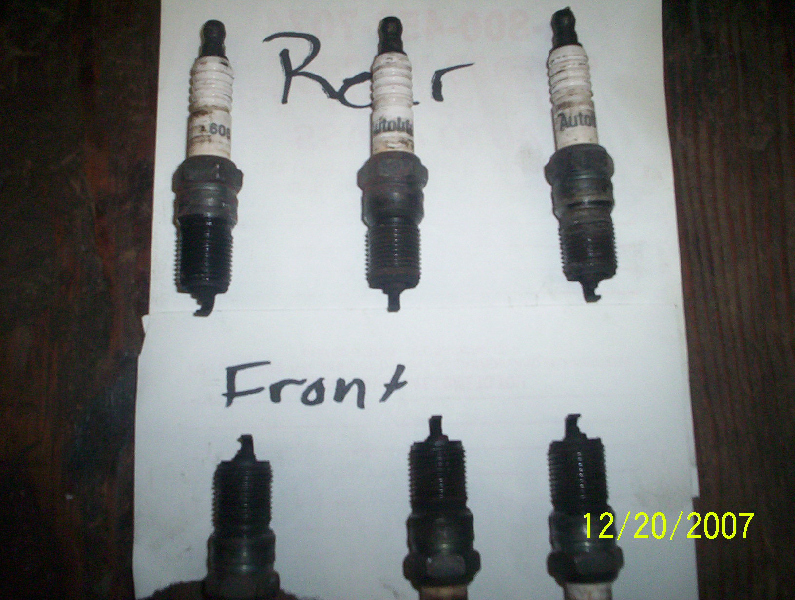

                            well today i put new plugs and wires on the car.. still does the same thing... so far i have replaced with new or known good parts; MAF, MAP, Coil pack assembly, the sensor that bolts to the coil pack mount above the rear manifold, Plugs, Wires, TPS.. i dont know what the heck is goin on here but i need help...!!! lol!!
                            Here are some pics of the plugs that were taken out..

                              The plugs look dark.. Hmm.
                              That "sensor" on the coil pack bracket was the evap cansiter purge soleniod lol.
                              Anyway, Take the vacuum line off the FPR and smell it and see if there is gas in it. Perhaps it's leaky and causing it to run too rich... Other than that a fresh O2 sensor might help but it could *possibly* be the 3/7x CPS.
                              Also you don't have a vacuum leak do you? Perhaps the LIM gasket is really bad off on it? I'd replace that if you plan to keep the car anyways as you don't want coolant in the oil...
