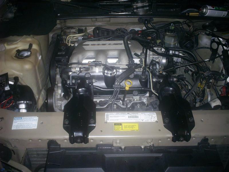

    I Need Help Now...Engine Doesn't Start
    I Had To Rebuild The Engine In My Lumina Since It Drank Like A Gallon of Water (LONG STORY!!!)...
    The Engine Is Now Complete...
    It Has Machine Shop Work In The Heads.
    Ported & Polish UIM, LIM & Throttle Body. (Matched To Gaskets)
    New MAF, MAP, IAT, IAC & TPS Sensors.
    New Lifters.
    New Spark Plugs, Wires And Coils.
    Compression Is 150 To 160 PSI In Each Cylinder
    The Inyectors Are All Activating In Their Order And Have Pressure
    The Timming Chain I Inspected But It's Fine And The Car Is in Time.
    Ok Now Here's The Deal...
    -As It Tries To Start I Noticed White Smoke Out Back.
    -Then Black Smoke.
    -Now I Got It To Start To Like 700 / 800 RPM
    But Here's The Catch...
    It Doesn't Start...But It Does Start To The 700 / 800 RPM Mark If I Put My Complete Hand On The MAF Sensor Closing It's Resourse Of Air.
    Besides That The Car Doesn't Start...The Engine Cranks Fine But Doesn't Start...If I Push The Pedal To The Metal He Does Like Starting Then Dies, After That It Throws A Backfire.
    I've Added A Picture Of The Engine...
    Any Help Now??? My Lumina Still Slumbers Thanks To This...
