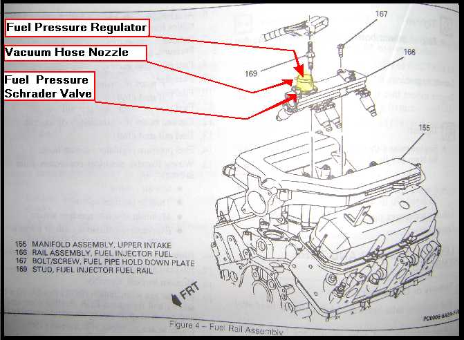

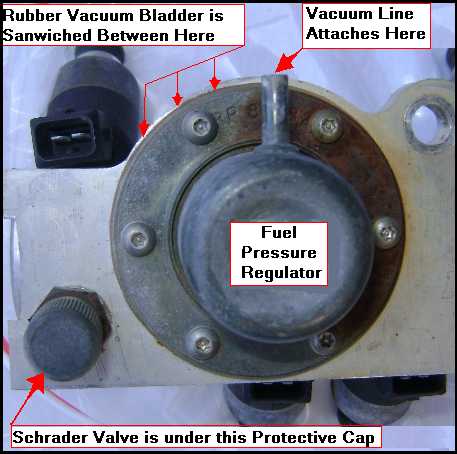

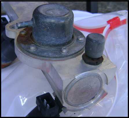

                Location of the Schrader Valve on a 93-94 3.4L Eng
                Originally posted by Dave_A View Post
                Leak as in fuel leak?
                Easy way to figure that out is get a fuel pressure test kit - if you have a fuel leak you will have a loss of pressure...
                Should be < 40PSI
                You can loan out a FP test set from AutoZone.
                These images show where the Schrader Valve is located for you to attach the Fuel Pressure Gauge. When you are finished testing for FP, turn off the engine and have a clean rag handy when you later remove the hose and adapter so fuel won't spray in your face or on the hot engine when you gradually unscrew the hose from the fuel rail.
                Is there any chance that someone put in either after-market fuel injectors or the wrong (over-sized) ones? The Stock GM Multec EFI is marked with P/N 17103007 and is rated at 18 PPH. If larger ones are installed, they will not only cause poor gas mileage...but in addition, the excess fuel can sort of "water down" your engine oil by thinning out the oil left on the cylinder walls during the cycling of the pistons and then migrate back into the oil pan. Once there... the gas in the oil will reduce the lubricity of any kind of oil you have in the pan and bad things will be happening sooner than later. You can pull the dipstick and move away from the car a good distance before you gingerly smell the oil for the presence of a heavy gasoline smell and this might indicate that someone before you installed the wrong sized fuel injectors in the engine. The rough idling is also a symptom of "big" injectors trying to put more fuel in the motor than the stock PCM can handle while trying to mix it with air. The same problem of "Gassy Oil" occurs with badly worn rings.
