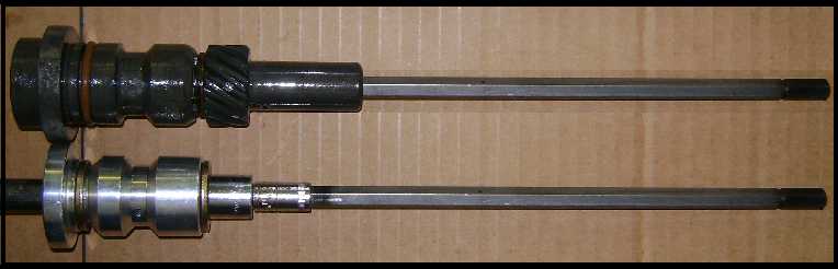

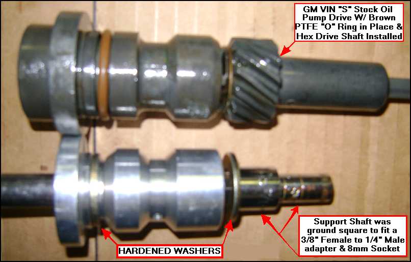

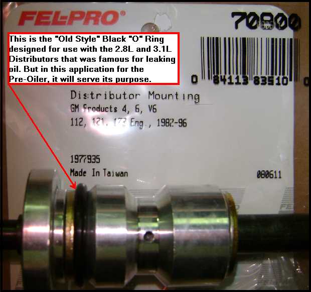

        IIRC, the newer versions of the drive shaft assembly for the transverse V6 engines have a male slotted end on the Oil Pump Drive that mates up to a female version on the newer Oil Pump Drive shafts. I have been so afraid of a similar failure in my current 95 GM 3.4L OHV RWD build that I bought one of the Pre-Oiler Tools made for the Chevy V8s and 90* V6 engines and heavily modified it to work with the hex drive shafts of the earlier 2.8L, 3.1L and 3.4L engines. (Please see the attached images).
