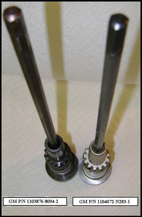

    I spied what looked like an Oil Pump Drive for the GM 3.4L V6 engine on eBay for under $20.00 (S&H Included) and since I could never find one anywhere when I tore down the GM 95 3.4L, I went through a lot of trouble to disassemble the stock one from this engine and wound up cleaning out a mound of carbon, gunk and crap that was trapped in the upper bushing chamber, I decided I might as well grab this one while I had the chance. (even if the seller was listing it for an '04 "3.5"...whatever that is)
    I thought that since they looked so close in design that even if it had a SBC style slot-drive in the end of the helical gear like the newer ones, I might at least be able to drive out the spring pin and try swapping the gear ends if it looked as good as it did in the picture and everything matched up elsewhere. To my complete surprise...the damned thing had a Hex Drive end on it that matched the stock TRW Hex Shaft...and in all other repects...it was a dead-balls-on match to the one I removed from the VIN "S" motor. Almost...

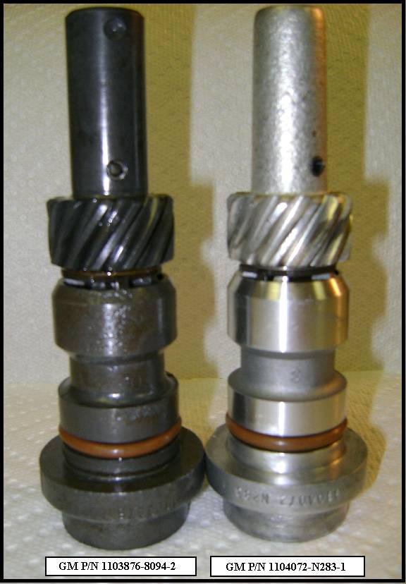

    And so I'm asking the more seasoned members of the forum to eyeball these photos I took and tell me if these very slight variations I noted are something serious to worry about. My concerns are as follows:

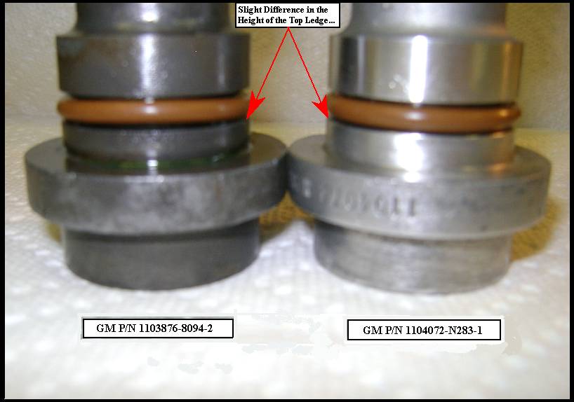

    (1) The distance from the upper portion of the "O" Ring groove sits about 1- mm lower down than the stock OPD.

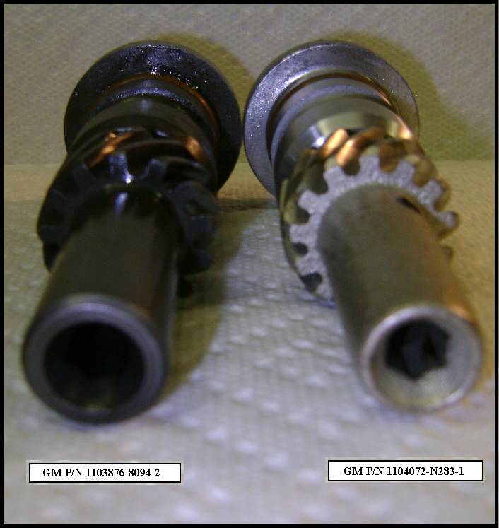

    (2) The top to bottom length of the geared section is slightly longer than the stock OPD and seems to have been cast, rather than machined from a heavier steel piece like the one on the stock OPD and it tapers a bit more down to the female Hex end of the gear piece. The gear teeth, helical angle, depth and number (13) are almost identical, however, they are just a smidgen deeper on the late model OPD, too.
    The two OPDs appear, in all other respects, to be identical, including the fact that the Hex Shaft heights on both are exactly the same when fully inserted and with both units placed side by side on a level surface. I would not bother with all this, but since I'm putting so many other new and upgraded parts in this engine, if I can upgrade the Oil Pump Drive as well at the same time, I'm very inclined to do so. The last consideration is that if anyone is seeking an alternative GM OPD to replace one that is either worn out...or not to be found anywhere...then this one might do as a perfect stand-in in its place.
    Thanks for your ideas on this...
    -==Bob==-

    Since I can only add three images per post...here is that last of the set of four OPD Comparison images...

      For some reason...I was unable to "edit" my last two posts...but I wanted to confirmd that both OPD units have exactly the same number of gear teeth at thirteen (13). Okay...the edit feature is working again...

        Not sure with the difference in metal color (one hardened more?), but the edge of the o-ring groove shouldn't matter at all. The gears are close enough either should work I would guess.
        04 3.5 would be a 3500 LX9 non VVT.

          I think what I will do is drop the new one into the motor to see if I can eyeball it from below how well the OPD gear shaft and camshaft teeth mesh... and with the motor turned upside down on the stand, then I can push the new OPD down and out of the block from underneath, without the usual hassle of not having any place to grip the damned thing to get it out after it is installed. If it feels smooth going in and out after being coated with some Mell-Lube, I think I'm going to go ahead and use it.
          I wish somebody had the specs on how these things are made because the newer one looks like the gear assembly was made out of "Mystery Metal". I did put them both in close proximity to a strong ND magnet and while it showed strong attraction to both, it seemed to respond from a distance further away with the newer model OPD, I suspect that it is probably made of either cast (because of its rough appearance) or it even might be forged, since the other unit has a well-machined surface with very fine tool lines all over it and the newer one only displays evidence of machining on the gear teeth. I should also mention that the original Hex shaft that came out of the (darker) OPD unit was all beat to Hell and worn from heavy or hard impact contact inside of the female Hex end. It looked as though the OPD Hex shaped housing containing it...was trying to strip the "Hex" right off the shaft...but only succeeded in flattening the true hexagonal faces on the shaft just a little bit. I noticed that the new, unworn TRW replacement Hex shaft fits more snugly in the newer OPD as opposed to the older unit, where more play was evident.

            Becasue of the expense of gear hobbing equipment, I doubt GM would change the gears.
            The cam and crank centerline didn't change on the 3500 (or even the 3900 from what I gather/experienced).
            The difference on color is the difference from the amount of carbon that has been introduced into the metal. Right after heat treating, everything is black because of the carbonized oil bath and the metal changing color during heating. This same phenomenon will stain the surface of the used parts in the same manner. Ever taken apart a motor with only a few thousand miles on it? All the parts are new and shiney
