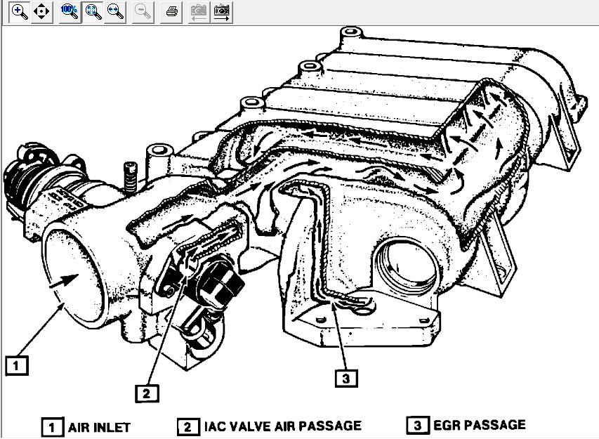

do you know what the IAC is? try unplugging it when the car is running, if its working correctly, the idle should raise to about 2500/3000 RPM. then plug it back in, and the idle should go back to normal. if not, that might be your problem
It's the metal sensor that sticks out about and inch on the fire wall side of the engine. It should have a 90 degree plug, its black and the are 2 star bit screws that hold it in the throttle body. At least that where it is if it's 3100, 3400. I'm not familiar with any of the larger engines. cept the 38001998 Chevy M VIN Mali LS with 99 Olds J VIN 3100 Swap

It also has a 4 wire plug since it's basically a stepper motor.-60v6's 2nd Jon M.
