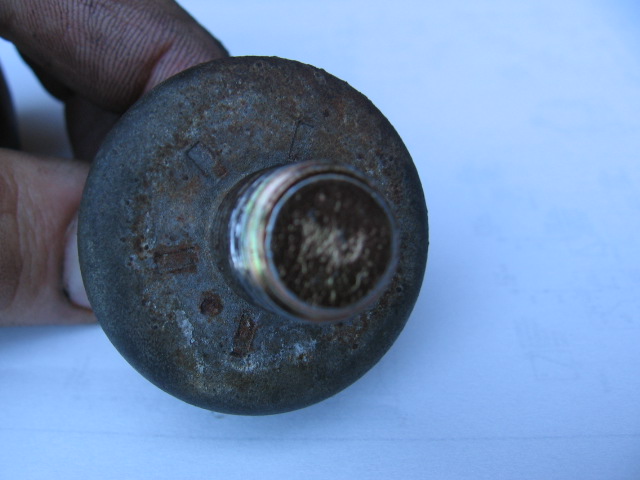

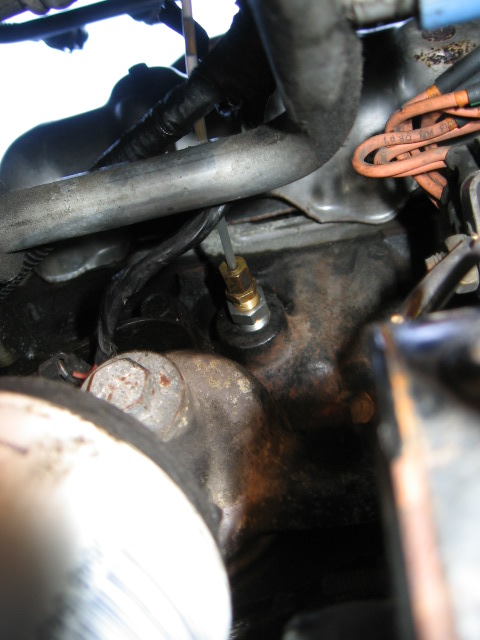

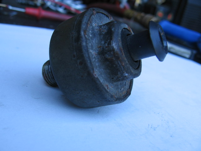

    94' Grand AM with Guage cluster, can anyone tell me where the oil pressure sending unit is on the engine? I thought i had it but not sure anymore, i attached a mechanical guage to the port and i got no reading. The sensor also has no hole in it, so i don't think its an oil pressure sensor, see pics...

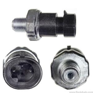

      The sensor you have pictured is the knock sensor. Rock Auto is very handy for having pictures of parts as well as parts cross reference. The sending unit for the oil pressure should look more like the attached picture. As for the mounting boss, I don't have a good picture but I can try and look for one. I hope this helps.

          I have seen them in 2 places on the GM v6's. Above the oil filter and above the starter.
            • 9190
            It should be just to the side (can't remember if its right or left) of the knock sensor. Your 3rd image is a coolant temp sensor. And the image wrath posted from Rock Auto is the version for just the idiot light. The gauge sensor is ~1" longer than that.
              it's right above the starter
