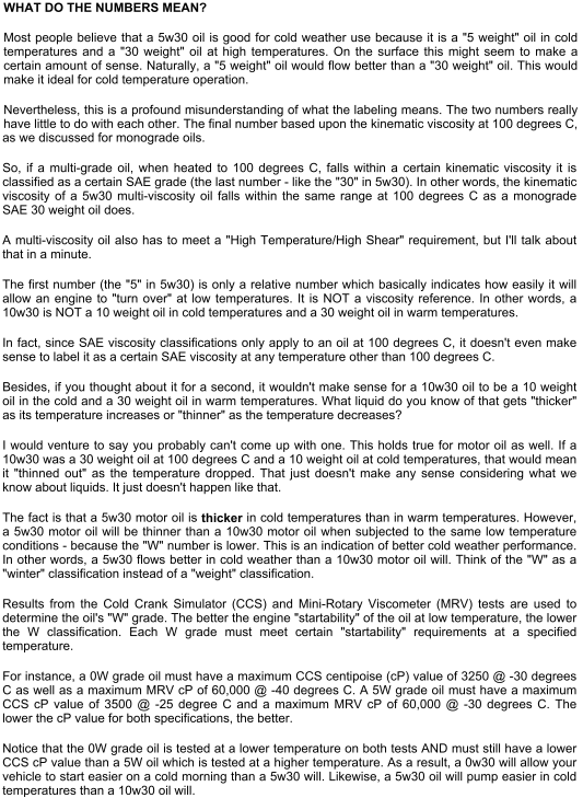

                  Here are a few more 'oily' Pearls of Wisdom on the subject matter...
                  http://www.motoroilbible.com/
                  http://www.ehow.com/about_5476705_mo...formation.html
                    #24
                    carbible and the Knize oil study: VERY good sources of info. the other two, i haven't been through yet.
                      #25
                      mind = blown...
                      i always thought the first number was a measurement of viscosity...
