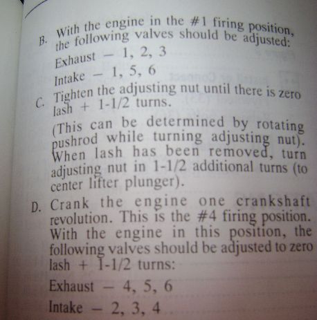

        If your talking older F body, vin S, you tighten while spinning puchrod with fingers, when there is resistance, Tighten another 1 1/2 turns

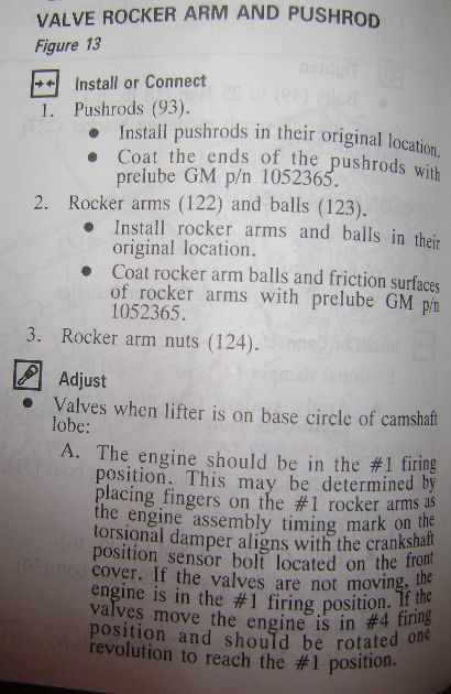

          Assuming that your nickname reveals your engine to be a 93-95 GM Chevrolet V-6 L-32 3.4L 207 CID VIN "S" engine, a more accurate piece of information comes now to you in the form of two screen prints of how to do this very valve adjusting job according to the proper GM 93-95 Camaro-Firebird Carline Series Shop Manuals:

                    I hope you realize that he was pulling your leg...
                    There is no fastener on your engine that requires 124 Ft Lbs of Torque... if you apply that much twisting force to the valve adjustment locking nuts anywhere on your valve train... you will either strip the threads off of the interior of the lock nut... or you will crush the rocker arm into the head and wind up snapping off the rocker arm support bolt from inside the head.
