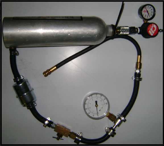

                            For the "Whole Nine Yards" on how to do this successfully... Please see this link to my Epic Post on this Project.
                            http://60degreev6.com/forum/showthre...=frankinjector
                            Here is the link to my photobucket that shows all three generations of how to build your own Off-The-Vehicle "FrankInjector Machine" and nearly 300 images and 30 videos on the build(s). The attached image shows what all the aforementioned components look like when properly and safely assembled.
