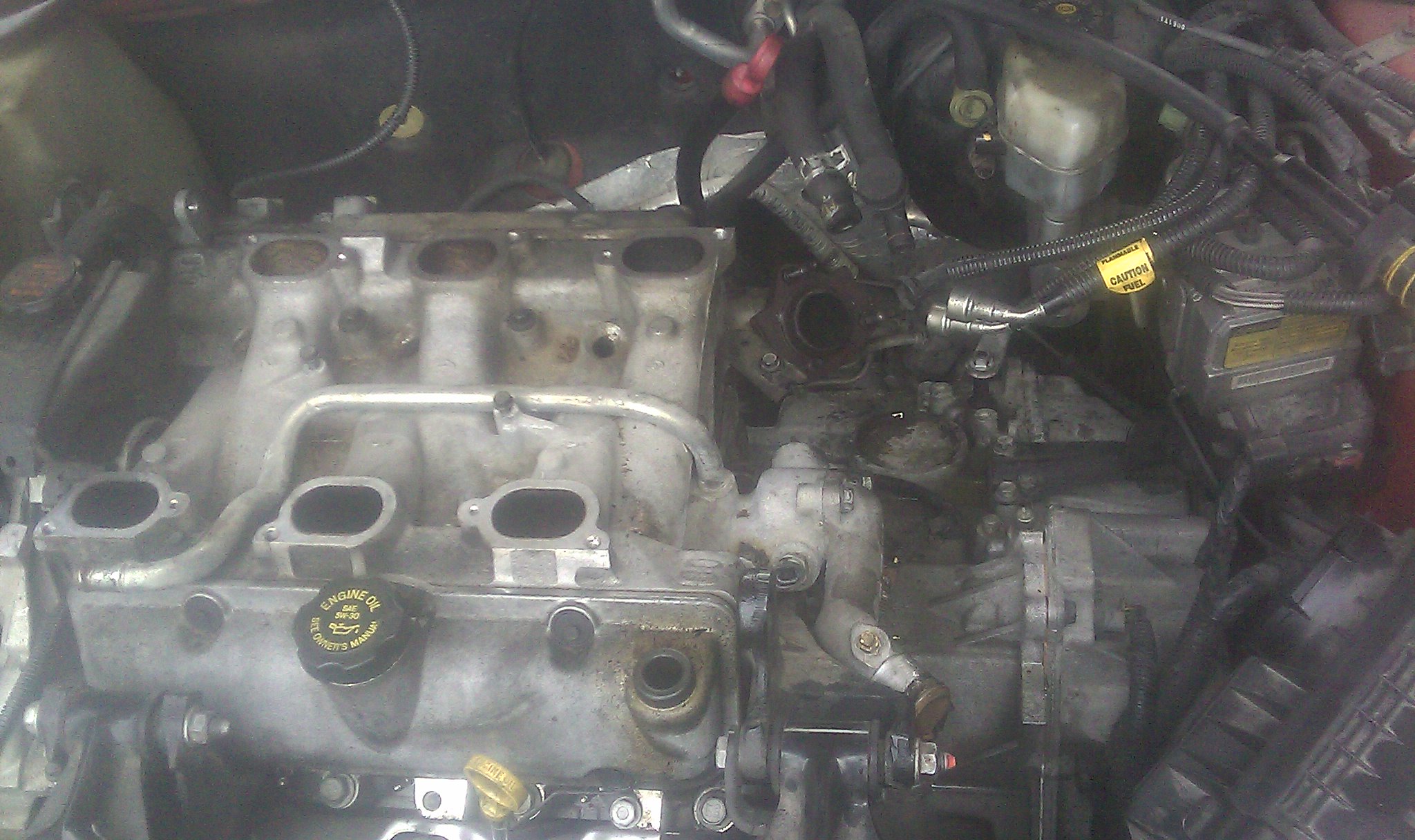

    Head/ head gasket repair ?s
    I have either a head gasket leak or a cracked head gasket(wont know till next week sometime) im currently in disassembly stage and just looking to see if there is anything that would be recommended to be replaced in a 3400 engine with 166k miles. Lifters? pushrods? rockers? Or should i keep it stock to not stress the bottom end. I want to up the performance of the 3400, i have but im aware that theres not much aftermarket available for that particular motor. Unless you plan on spending 3k on a ground up engine rebuild for mediocre hp gains. I would like to start with a pcm tune. What is the best bang for your buck on that...

        Well i was kinda exaggerating. i would love a cam swap but unfortunately its not an option for me as i dont have the facilities to do so. So, as far as the lifters that are currently in it, do i leave them alone or change them while its open. what else should i look at.
