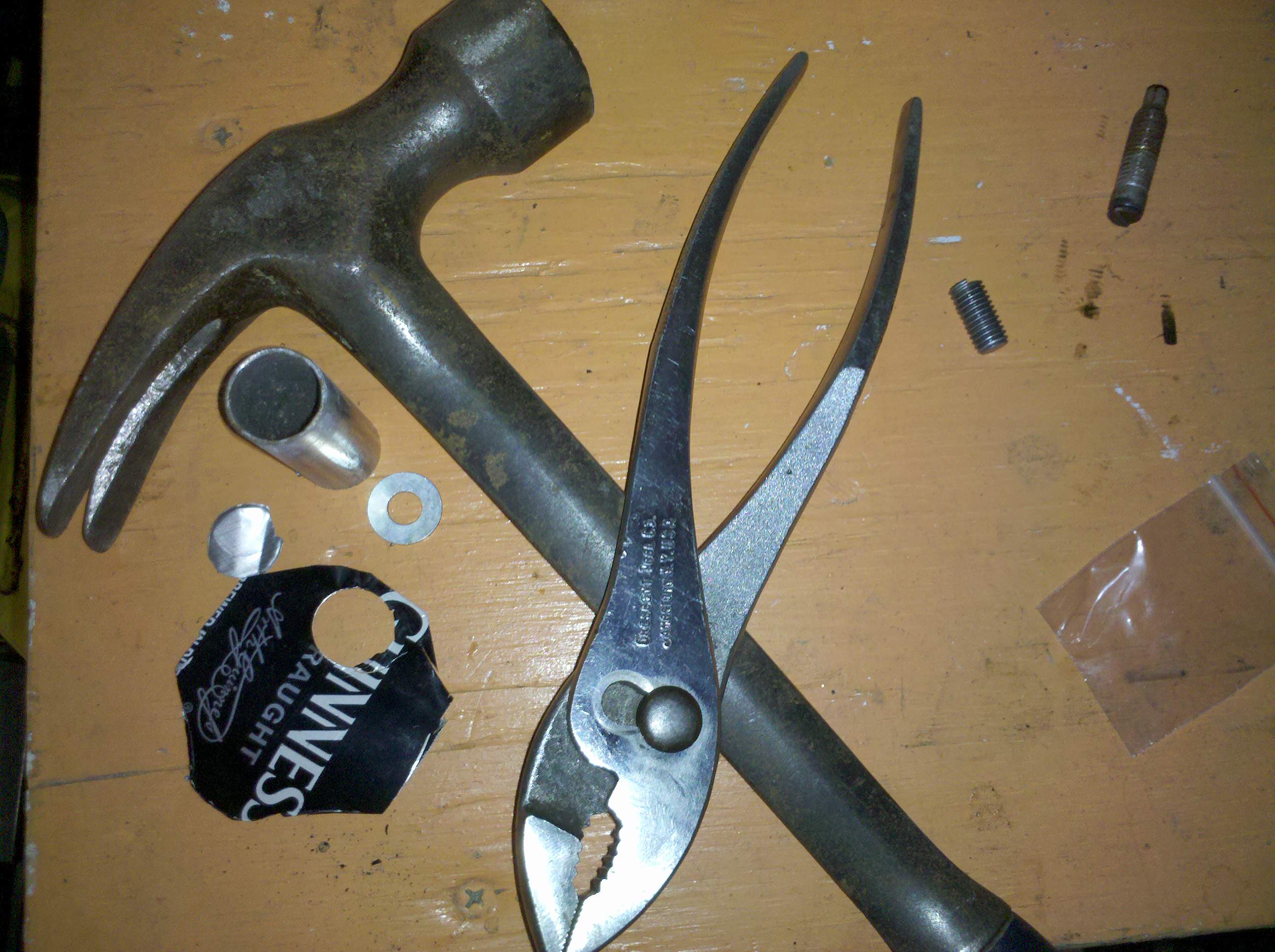

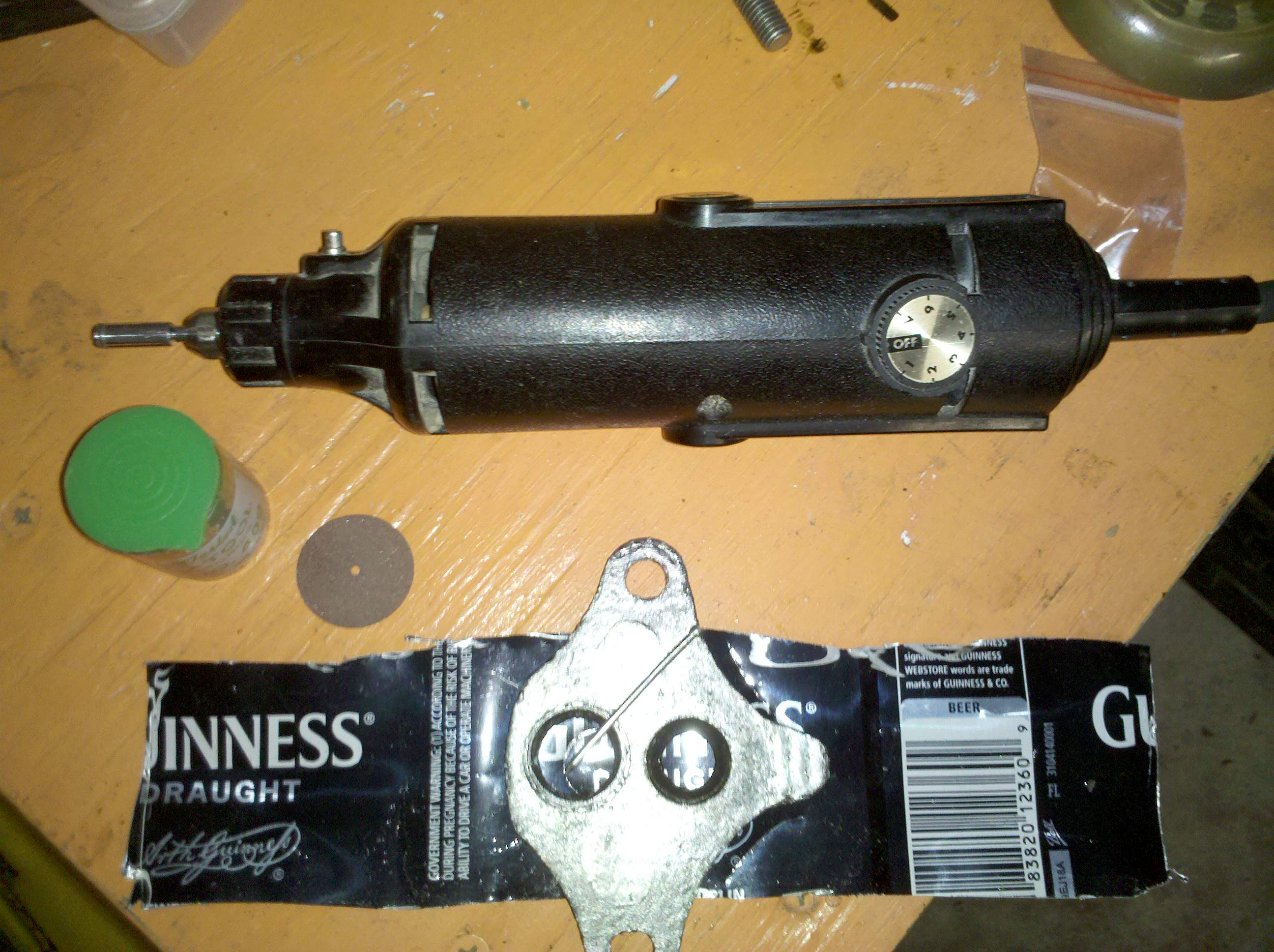

              Blocking off the EGR doesn't seem to help. But we'll give it a day or so of city driving to make the final determination. Here is how I did it.

                It didn't look like the pintle needed the room but I made a hole for it with a washer and a socket slightly larger to make a blanking die. Hit with a hammer and then work the rest free with pliers.

                      First, that block off didn't change anything but did produce a trouble code for low EGR flow so I'm back to the stock configuration. I also checked that the fuel pressure regulator would hold a vacuum so that part is OK. (All this regarding the rumbling idle.) Once I get a fuel pressure gauge I can rule that out. What's left is comparing the 7x sensor and cam sensor on the same scope to see if their timing relationship stays constant. All in all an awful lot of trouble to get rid of an annoying sound.
                      Also, I looked at my last post and it looks like I should have been calling that valve a poppet rather than a pintle.
