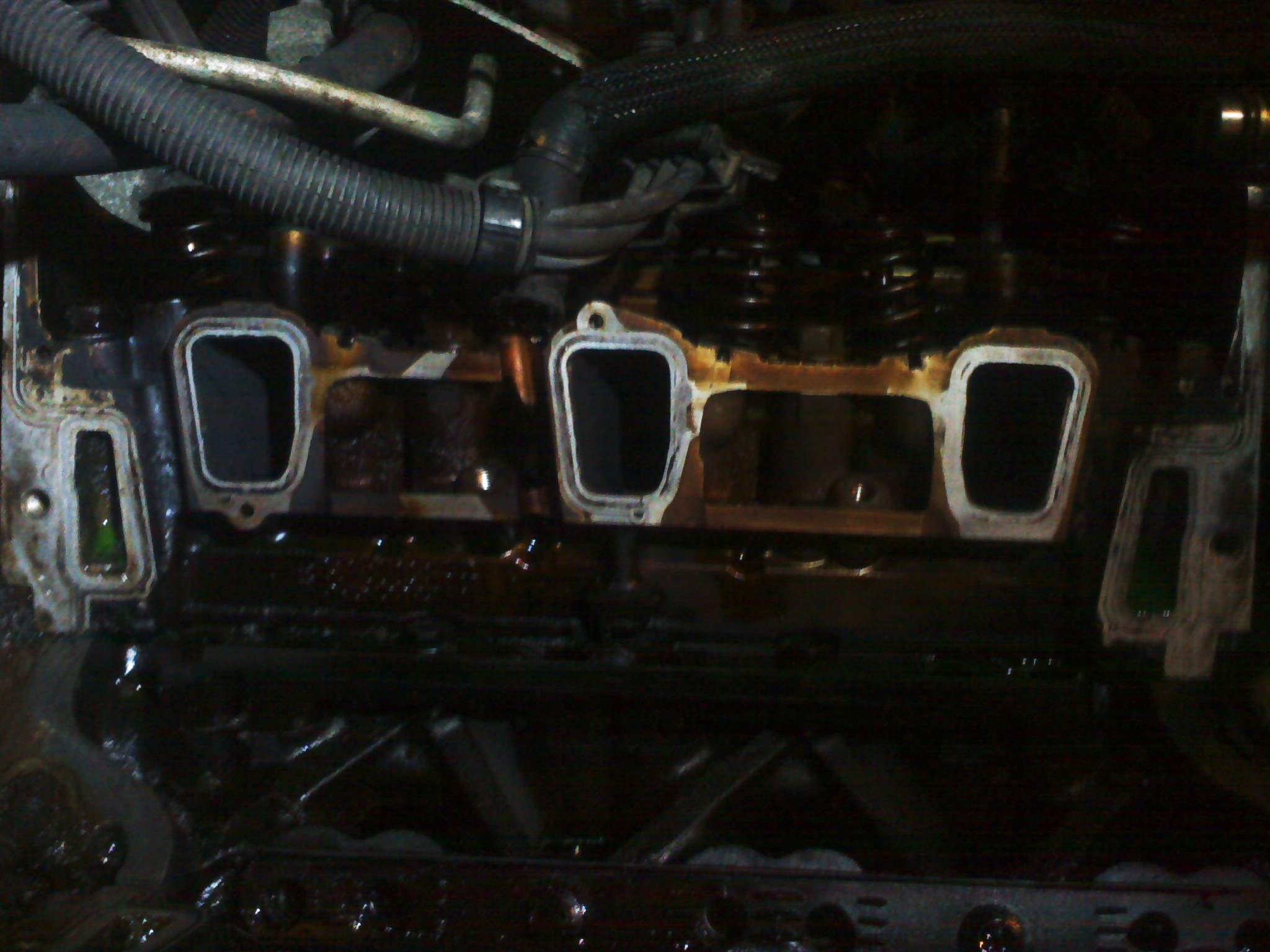

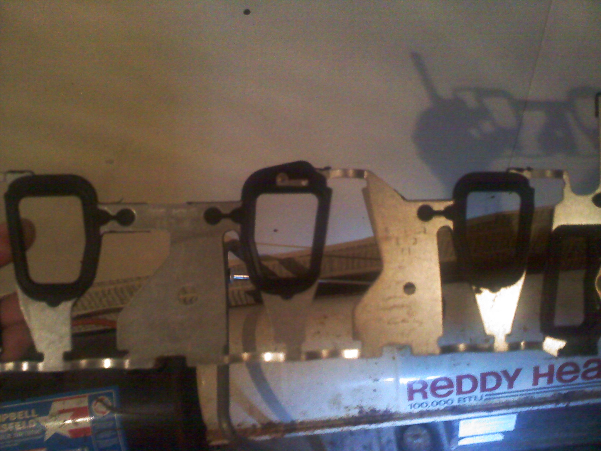

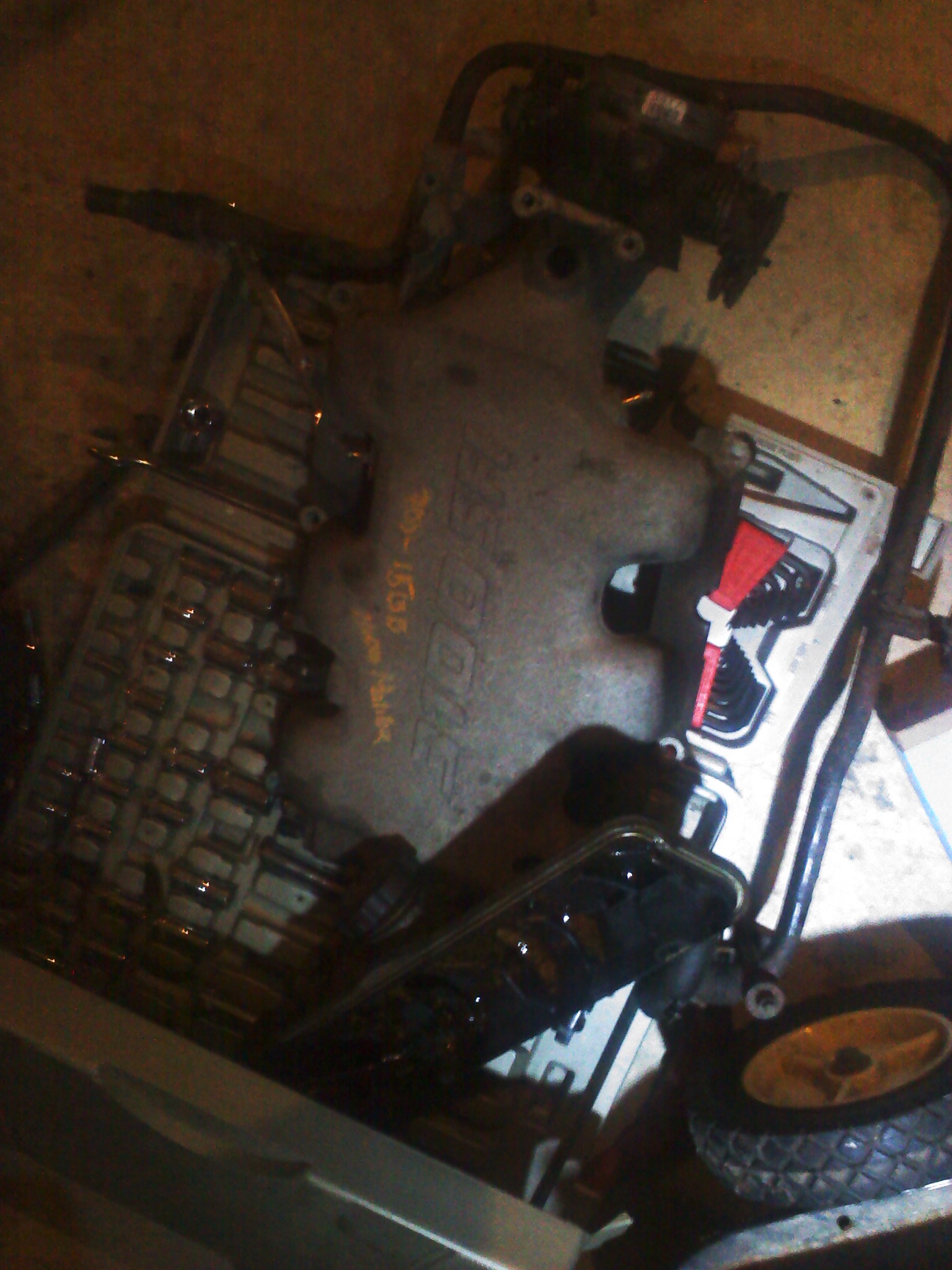

        Here are some pics. head,vin,gasket, upper intake(yellow writing says 2000 malibu)
          Don't take this as me thinking you don't know what you are doing, it's just a simple guess on my part and with you already having one of these fixed not knowing what you are doing doesn't cross my mind at this point. I'm just trying to rule things out. I've edited your pics to try to help out here. Now in yellow, I've circled a tab in the gasket pic that mates to a hole marked in yellow in the head pic. Also use the angled walls in the ports (marked in green) as a reference as to which way to flip the gasket. From the way you have the gasket facing right now, it would have to be flipped (left to right) to fit the head correctly.
          I hope this helps, and I hope you don't take offense to it. Like I said, I'm just trying to rule things out because those look like the right gaskets.

            Thank you for the illustrations, I'm not thaaat dumb tho haha.. I don't take any offense to it at all haha. :P.
            Its not a problem of not knowing where the holes go its a problem of the gasket seeming almost too tall and the nipples don't match up with the hole. The middle of the gasket seems too long or something and it bottoms out before seating all the way and letting it plug in. Its really pissing me off. I'm about to cut part of the bottom middle out.

                Got it all figured out guys!! Autozone just so happened to give me the wrong gasket 2 god damn times... Thats just insane. I took the old one in and had them match it too lmao.. What idiots. Putting it back as we speak.. should run forever now :P.
                  What exactly did they give you gaskets for then? I ask because those look like 3100/3400 gaskets. Yeah, our Autozone people around here aren't too bright either... Rumor has it there are some with some knowledgeable people though.
                    Could have been the 3500 gaskets... Depending on which Malibu they looked up.
