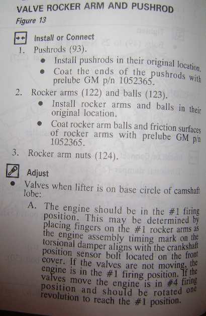

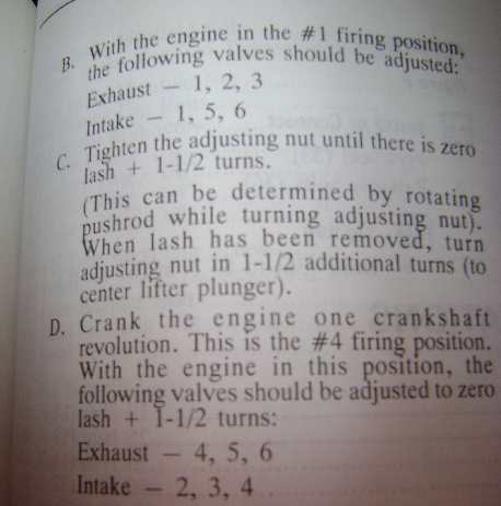

                    Originally posted by 3400beretta View Post
                    I checked my 94 fbody gm service manual, and it says the same thing you say for the 3.4L, 1.5 turns past zero lash. You sure you have the engine in the right spot? #1 tdc you do exhaust 1,2,3, and intake 1,5,6. #4 tdc is exh 4,5,6, and intake 2, 3, 4.
                    The only other thing it can be is if your lifters are compressed. I can't see every single one being compressed though.
                    Edit: I just checked my 94 Lbody service manual as well, and it says exactly the same thing, that is for a 3100. So it has to be correct, no way they are all wrong.
                    Here are some supporting scans to precisely back up Mr. Pink's information and give you something you can print out and use...
