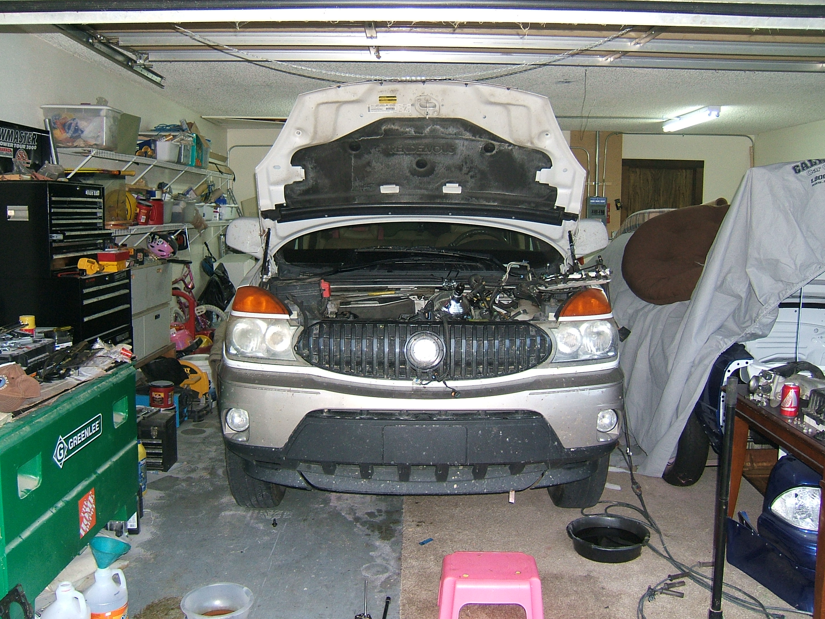

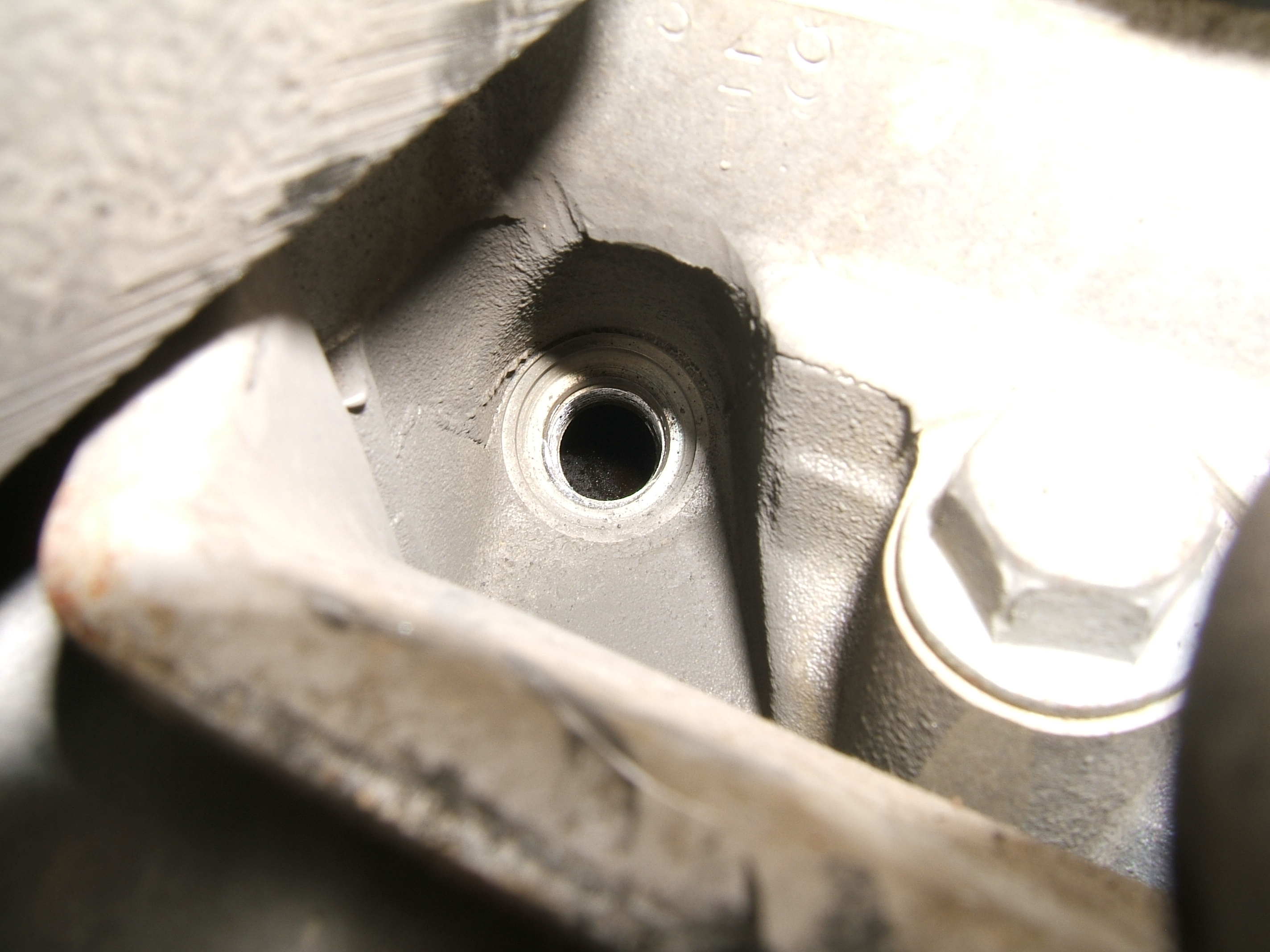

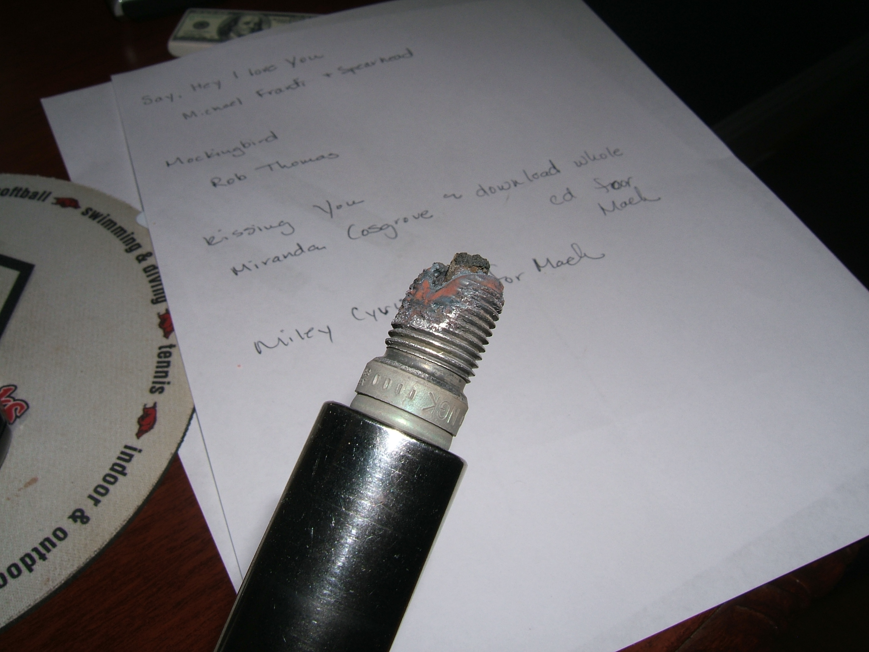

            • 9191
            Anyone ever helicoiled a spark plug hole at home? I'm contemplating it, as the new spark plug appeared to be leaking as well. So I tore it all down. I've got the front head off, still need to take the plugs out to look at the hole better. Just trying to decide if I want to try to do it myself, then put it all back together tomorrow, or take the head to a machine shop to have them fix the hole, then reassemble Mon, and possibly Tues evenings.
            I may need to source a new crank sensor wire as well, as the current one got in contact with the exhaust manifold. It doesn't look like it melted down to the wires, but the 2 insulations are definitely melted together. And of course, I broke all 3 crossover studs, so I need to get some of those as well.
            • BLADE
              • Mar 2010
              • 78
              #21
              I had a helicoil in a truck and the spark plug stuck in it and broke the plug off in the head donot recomend a helicoil or definitly use antiseze on the plug and watch the torque

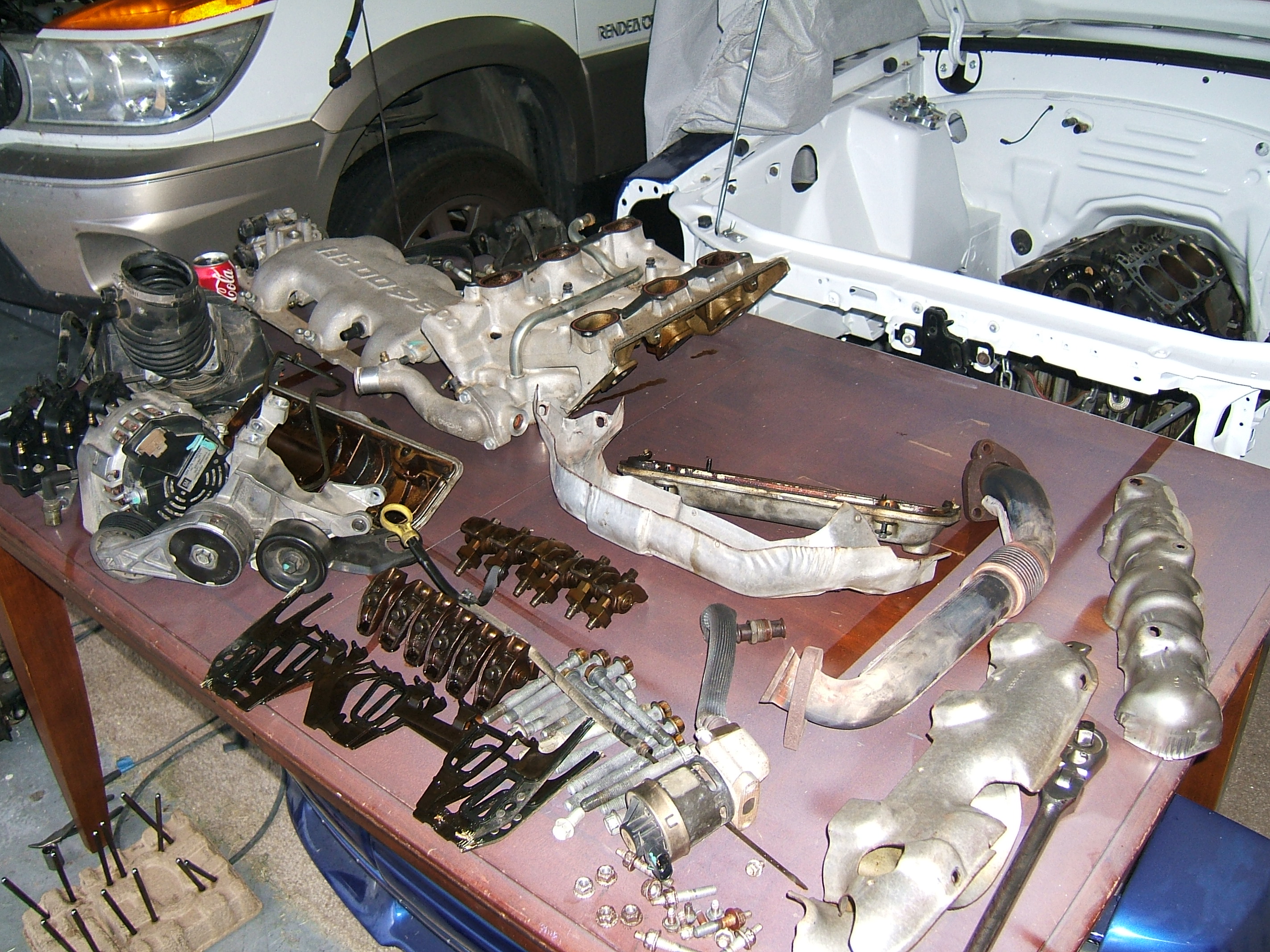

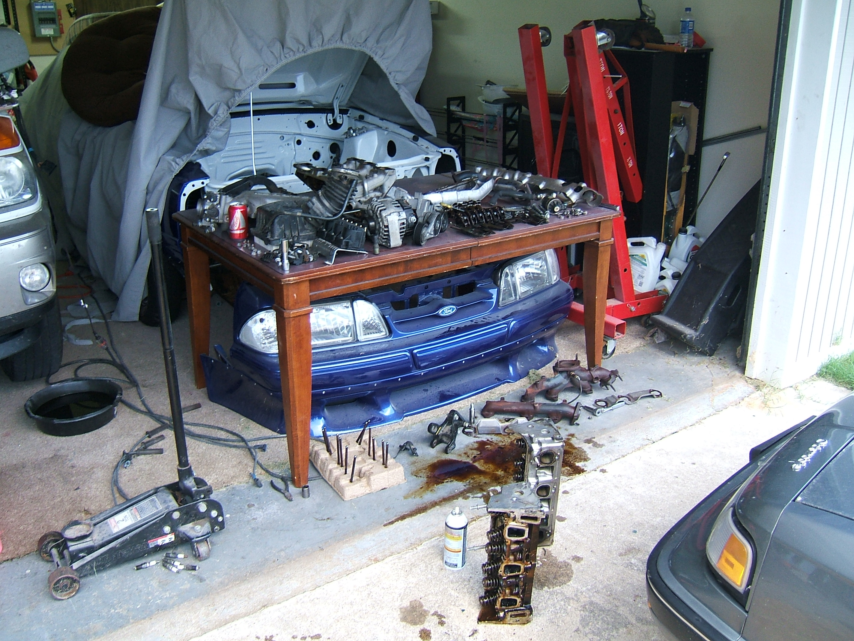

                  • 9191
                  #23
                  Ended up tearing it all the way down, and will be taking both heads to the machine shop tomorrow to get worked on. It appears that the spark plug in #2 wasn't the only thing potentially leaking. Had a broken exhaust stud there was well, and its inside the head, so I'll get to give the machine shop even more money....
