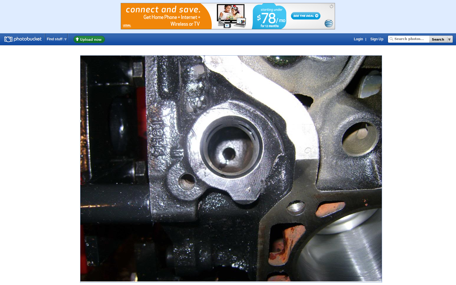

            I'm not certain for your LX9 Engine...perhaps you will be lucky to have an Oil Pump with the slotted design like the SBC V8 engines and the Priming Tools can be found for around $20-$30 at Summit and RockAuto. If not... several years ago, I came up with a design for an OPPT "Oil Pump Priming Tool" that works well with the Hex Drive Shaft driven oil pumps for the early 60* engines because it actually seals well enough like the original Oil Pump Drive Unit when held down with the two prong claw to ensure that oil is making its way through the upper oil galleries under enough pressure to do some good. Here is a link to the tool and instructions on "How to Make Your Own" are embedded as part of these images. {Please note that others may have some alternative simpler ways of doing this that are not so precisely involved as this thing):
            The attached image shows the OPD insert hole into a 1993-1995 3.4L L-32 Engine to illustrate that if a straight shaft as in the style of a SBC Oil Priming Tool were used in this case, the open oil channel galleries leading to the lifter cavities would not have a great deal of exposure to the lubricant... without being sealed via an "O" Ring at the very top of the back of the engine block... hence the complexity of the tool to prevent this from being a problem.
