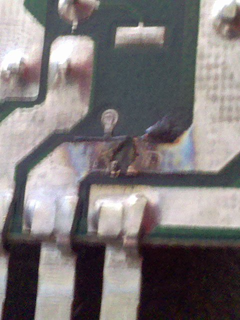

    Saved 50 bux with a bit of R&R, and a soldering iron. Was a bitch to get to, but you can see what the obvious problem was. Pic is not quite perfect, but that area is about the size of your pinky nail. All of this because the previous owner put in a new window motor, and got the harness back in wrong. And for any future reference, the module is right above the center hump attached to the firewall.
