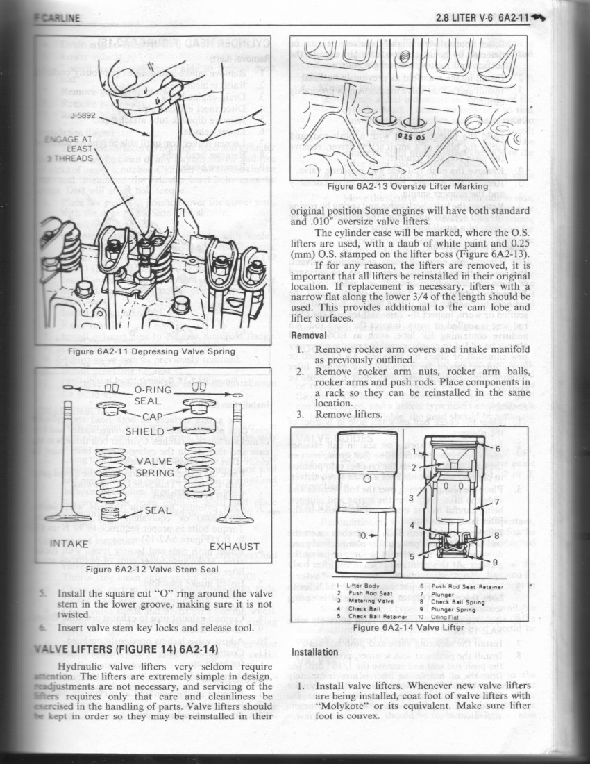

    hey guys , i have a rwd 3.4l that im working on, replacing the valve seals. due to oil in exhaust port.
    Reading the forums i notice that some recommend installing the felpro ss72527 positive seals on both intake an exhaust. an also using the black square cut oring in the 2nd groove on valve stem. is this correct?
    also i read that some are using a ratail file on the exhaust positive seal to give it some artifical wear before installing it .to get more oil to exhaust valve.
    Is this necessary? with the felpro positive seals ,or did this technique stem from teflon seals.
    also ,if i used positive seals on exhaust valves should i remove the oil shield located under retainer? to get more oil to seal.
    what do you think guys, Rob

    Use Small Block Chevy Viton valve stem seals on all the valves. Keep the O-rings and ditch the umbrella under the retainer. If your doing any upgrades to the motor then install COMP Cams valve springs now. If it is all going to stay stock then just re use all the hardware.
