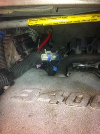

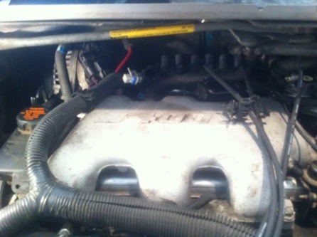

    I just finished putting my parents van back together after doing the intake manifold gasket and have 1 wire harness that is not plugged in and have no idea where it suppose to go so I need some help. Thanks in advance for the help

    It's a 2001 Pontiac Montana

      Hard to see but looks like an O2 sensor plug.

        Thanks for that.
