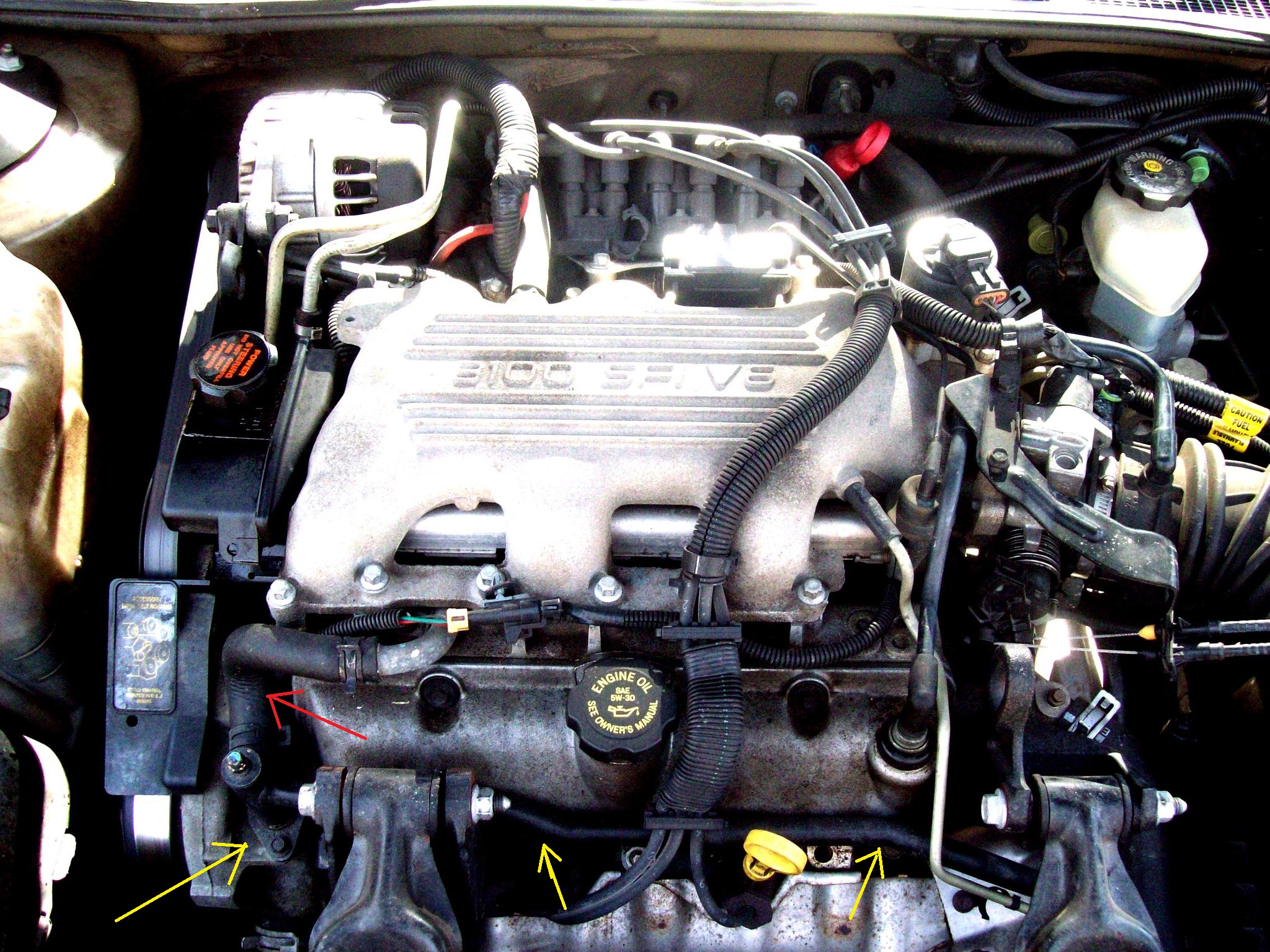

    Hey guys, I am relatively new to doing DIY maintenance to my car. I have a 1999 Lumina base with the 3100, and I was just wondering what the name of this part(s) is/are that I need to replace. I drew arrows where the coolant line runs that needs to be replaced, the yellow arrows represent the hard line that goes all the way back behind the engine and the red arrow represents the little connecting line that is leaking. The yellow arrow all the way to the left points directly where the one leak is at, and the other leak is just below that retaining clamp on the little line on the engine. It's a very very small leak, but since I recently changed the intake manifold gaskets it just annoys me that it is there. Basically I just need to know what these parts are called so I can purchase them. Thanks!

          This seems familiar to me... It's either a deja-vu moment, or this has been posted as a thread (with the same pic) before. I've still no idea what the technical name for that hose is, sadly.
          Either way, after looking through hoses on Rock Auto for a 3x00 vehicle, I've come up with this:
          ACDELCO Part # 14156S
          $2.47
