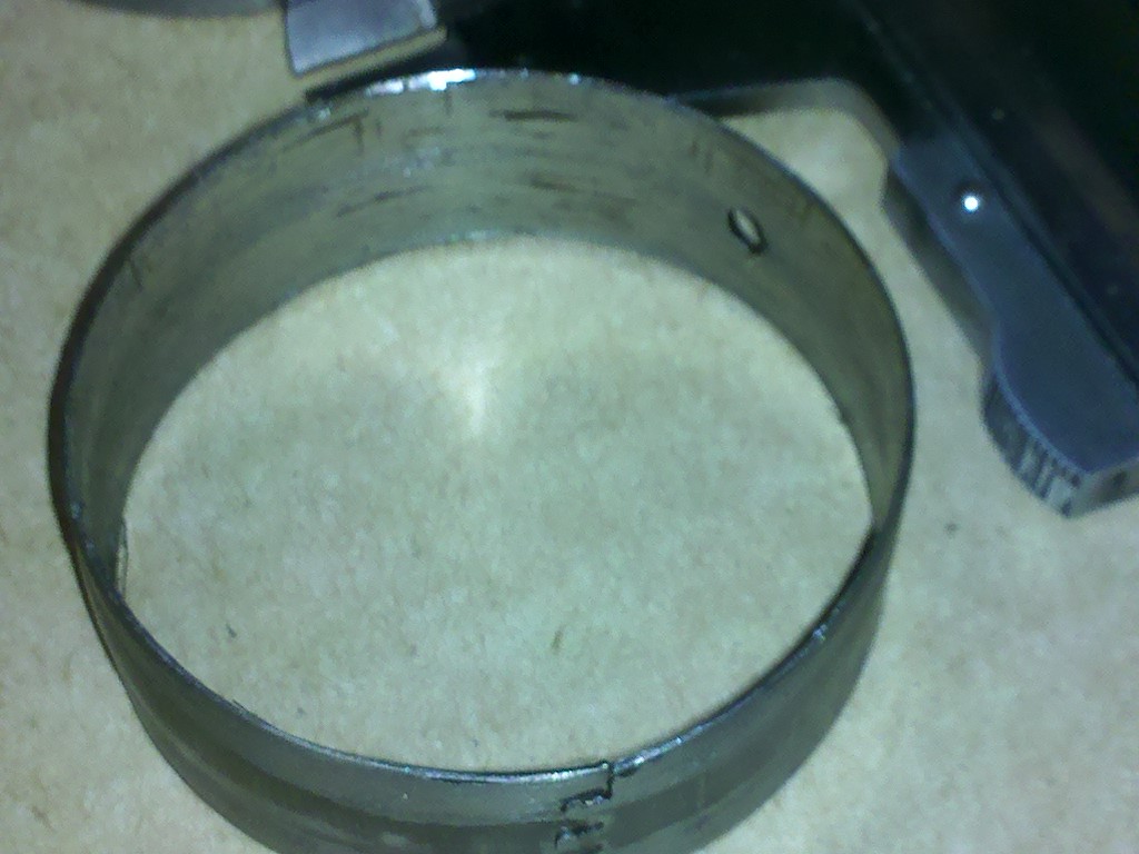

      Just a quick reply until I post pictures of the old bearings tonight. No doubt the inner bearings were spun. The outer ones have a swath worn to the base metal (copper/brass color) all the way across the bearing's width.
      We're the original owners of the vehicle. I've seen pictures of coolant problems due to LIM failure. If there was ever any coolant intruding it was too small to see. Every time I've had the LIM off (3 times now) the gasket surfaces have shown no signs of failure.
      I have a feeling it may have been related to wear and oil problems. 18 months or so back the head gasket failed leaking coolant into the #2 combustion chamber only. We took care of that very quickly, I don't think the temp ever got to the top of the normal arc. And probably 15 months ago the p/s pulley snapped so I drove it on short runs with no belt to get it home. It never got to redline temp but who knows, maybe the cam bearings were hotter (high mileage engine) and it set it up for eventual death.
      What's left of the cam bearings indicate it was intact and there was oil pressure right up until they spun and caused it to snap.

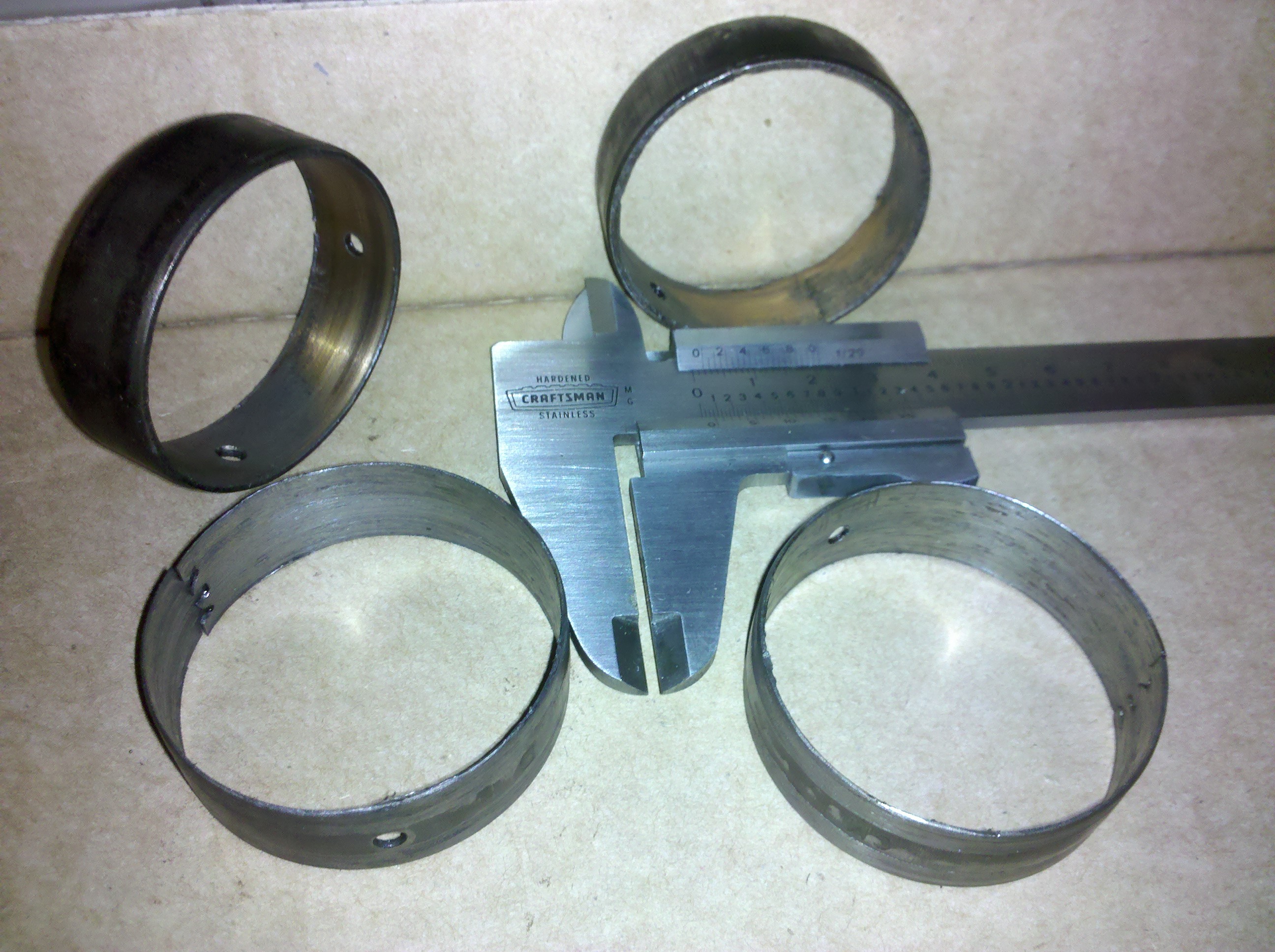

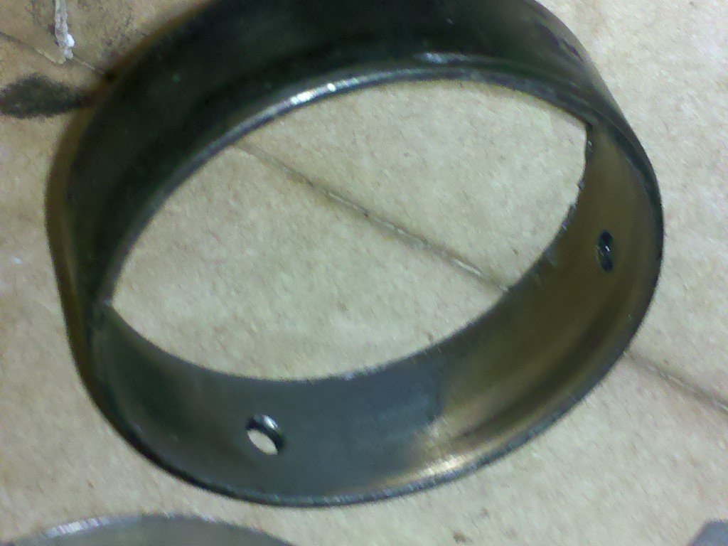

              #21
              Here are the cam bearing pictures. The front 2 came out close to the same thickness, I give 1 measurement for them and then the two spun bearings.
              0.069"
              0.047"
              0.033"

                  Another thing to remember, stock cam bearings are nothing special... This is on a decently low mile motor... The rod bearings did not have this type of wear, and this was all stock components.
                  Copper was also starting to show on the front bearings.
