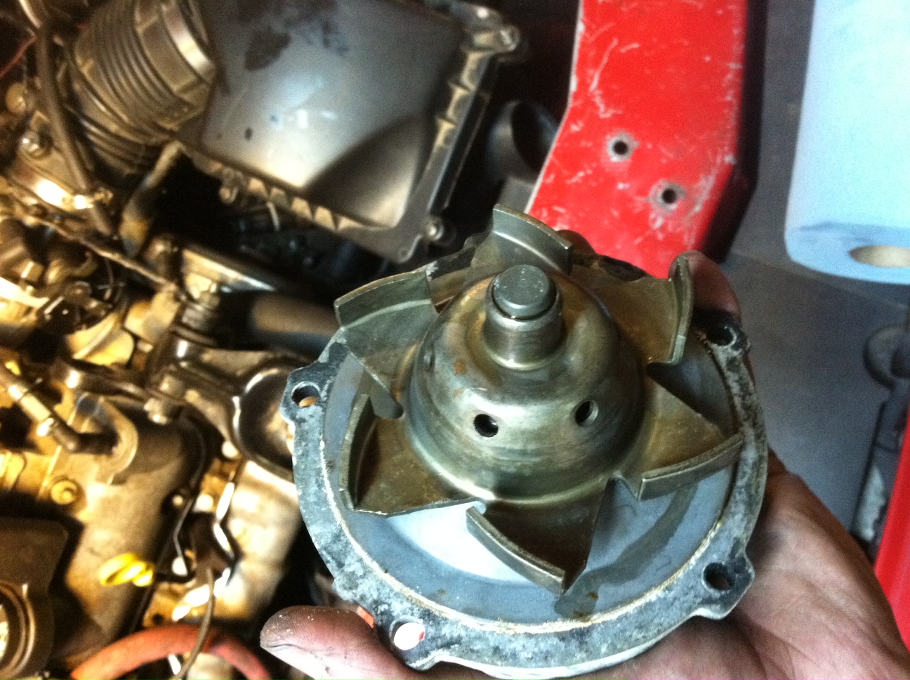

            BUT... the results are in, sort of. I replaced the ICM and Coils with a spare set. Fired the motor up and it ran fine. I noticed it is idling smoother. It wasn't rough before but the new ICM/Coils seem to have smoothed it out some. As to whether or not it fixed my high rpm miss, that I don't know because after I started it up I heard this chirping coming from the accessory belt. I pulled the belt and checked each pulley. Water pump had some slop in it. DAMN. At least I had a spare pump from the dohc motor so I didn't have to spend any money. Removed the LX9 pump (more on that in a minute) and installed the dohc pump. Didn't have any fresh coolant so I couldn't refill and drive. I did fire it up for about 5 seconds to verify the noise was gone - it was.
            Now, this LX9 pump, check this pic out. What is this funky impeller. Its a weird shape and is stamped steel. The shaft has a bit of wobble which was my chirp sound. At 52k miles I'd think this was the original waterpump but it sure looks like an aftermarket one. Is this what GM is using now?
            Anyway, I'm going to pick up some new coolant tomorrow after work, fill, bleed and then hopefully rev to 6k with a solid ignition.

              That's the junk piece of crap stamped steel impeller used on reman water pumps. The original would have been cast and had many more fins. A DOHC will not run cool with one of those, and neither will a performance oriented 3x00. That is for sure a replacement, and the one to avoid. 52k sounds fishy...

                I had a water pump like that. I ditched it for the revised one, new.
                  I think that's the standard one that comes in the 3500.. i remember taking mine out several years ago and it being similar to that.
                  I never had cooling problems with it.

                      IIRC thats the same style pump that was on my 05 3400 and it's still there to this day... never had issues with it.
