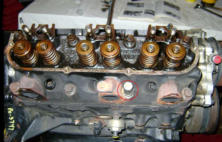

    If like me... you own F-Body cars (one of which sports the L-32 3.4L V6 Engine) that use these fasteners, you'll find difficult to get your hands on the two unusual “double duty” fasteners that also just happen to be part of the eight [8] bolt sets per head that require brand new replacements. But recently I discovered a way around this agony by combining
    two sets of bolts made by two different manufacturers and allow you to come up with a complete set of new head bolts and solve the problem.

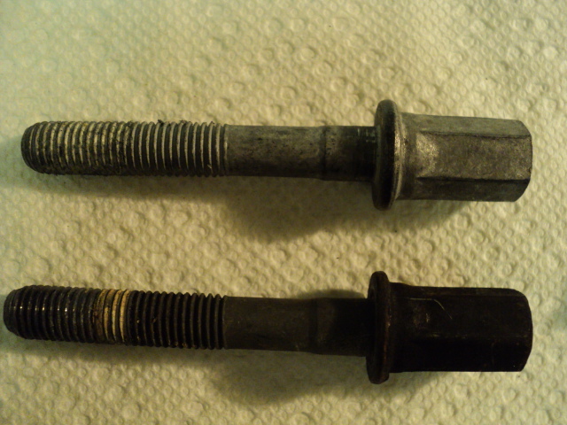

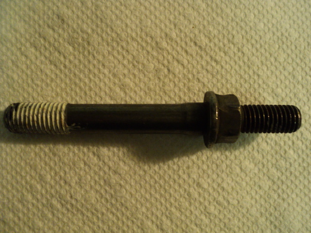

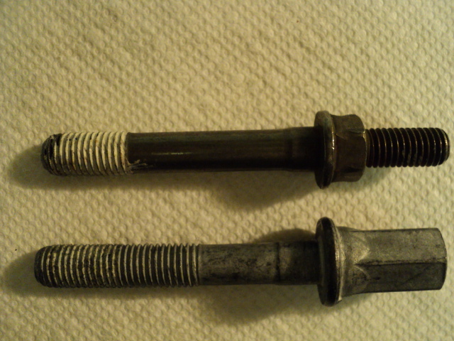

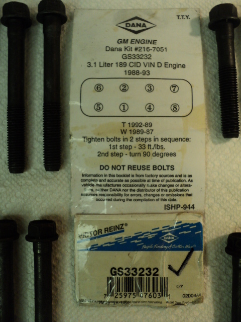

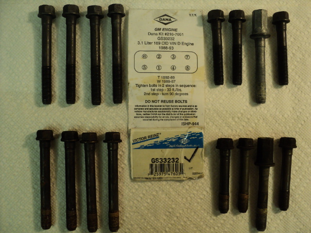

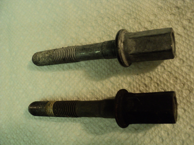

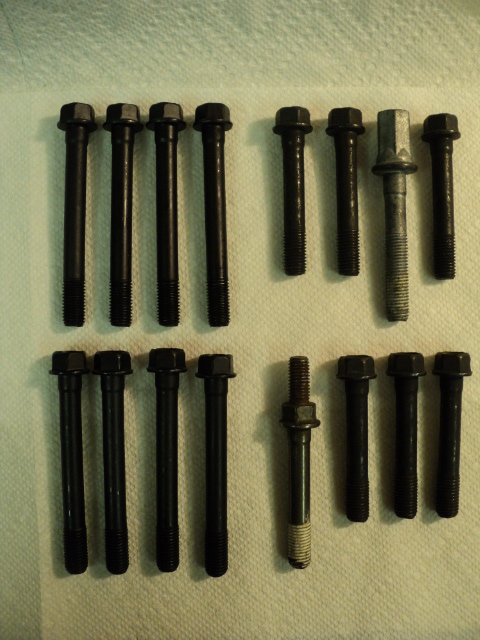

    The link above and the images attached below display one set made by Dana (Victor Reinz) listed as Dana Kit # 216-7051 with a model number of GS33232 and within this eight [8] bolt set is the one special "Female on Top" Hex Bolt needed to act as the support the attachment for the Alternator Bracket Hold Down Bolt on the passenger side of the V6 engine, The other set of seventeen (17) bolts comes from FelPro Model Number ES72857 (Future Part # will be 21-1122) which includes that special “Post Bolt” with an exposed upper threaded stud portion that serves also to hold down the front of the engine head on the driver's side of the V6 engine when properly torqued. You can see from the images that while the Dana Bolt set and the FelPro Bolt Set are identical in their short and long bolt lengths as well as having the proper 11.9 Hardness Level... the Dana set are threaded to a greater length than required in the L32 engine block. By simply swapping in the Dana Alternator Bracket Bolt for one of the shorter bolts from the FelPro Bolt Set... and Voila!... now you have everything available for a brand new and complete set of speciality head bolts to do this job right! One word of caution here for the F-Body owners...about this final "Mix-Master" set of head bolts you wind up with... use the original factory torque instructions for your specific engine to tighten these down and NOT the ones listed on the bottom of the Dana Product Instruction sheet... those only apply to W-Body and T-Body Car Line series of vehicles. For those who don't want to muck around with doing it this way, there is another alternative in just buying the 17 bolt set from FelPro and then hunting down either one or both of the speciality bolts via these GM Part Numbers:
    GM P# 14097629 - Stud on Top
    GM P# 10065500 - Extended Hex on Top
