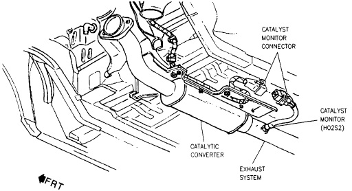

                        Two ways you can approach this.......
                        Remove the cat by unbolting the exhaust upstream and downstream. It will be a length of exhaust pipe. Cut the old cat out. Try to cut out a length equal to the length of the replacement cat. Keep in mind you will want an inch extra on each side for overlap. So if the replacement cat is 14" long, cut out 12" worth of space with the old cat. If the replacement is too short, get some pipe at any autoparts store. Keep in mind you want overlap so pay attention to inner diameter versus outer diameter.
                        You then will want to clamp it well. Don't use the cheap horseshoe like clamp. Get a band clamp for overlapping joints. They seal better.....but if you can get it welded, do it.
                        Do NOT use the flex pipe found in Advance Auto Parts. It leaks after time and the Cat gets REALLY hot. So do not use anything but metal. No RTV or any other non metal gaskets.
                        Great band clamp for something like this. You do not want a leak under neath the chassis. It WILL get into the cab easily an poison you over time.
                        If it is a direct fit, you gotta simply unbolt it.
                        All of this means you will be under the car. Be sure to use proper jack stands on solid, level ground. Do NOT get under the car with just jacks holding it up. A big guy like you won't stand a chance if it falls on you. Don't be a statistic, be safe.
                          [ATTACH=CONFIG]6662[/ATTACH]
                          thank you for all ur help, i spoke with my brother and hes gonna assist me in gutting the cat and rigging the 2nd O2 sensor so it reads as if the cat is still inside and working, we live in Florida, theres Nothing about emissions here, hence why i never knew a cat could cause so much trouble, ive never had a vehicle with one installed, besides my 91 lesabre and i didnt drive it for that long either
                          if i were to buy the magnaflow one in the future it is a 100% Direct Fit no cut required cat... i have more rims/tires than you can shake a stick at, so i use some to make sure if it does fall it lands on tires and not on me... i can go under cars and have for many years, but with my back problems i try to avoid anything that would cause me to be stuck in bed with sciatica which includes working under cars or bending down into the engine bay, hell i cant even stand for more than 20 mintues... but im not gonna pay someone to work on my car or her car bcause i dont trust anyone elses work, UNLESS its something i absolutely cannot stand to do or just dont have the tools with power to complete the job at hand, but i have a guy i buy tires from that will do anything i pay him to do
