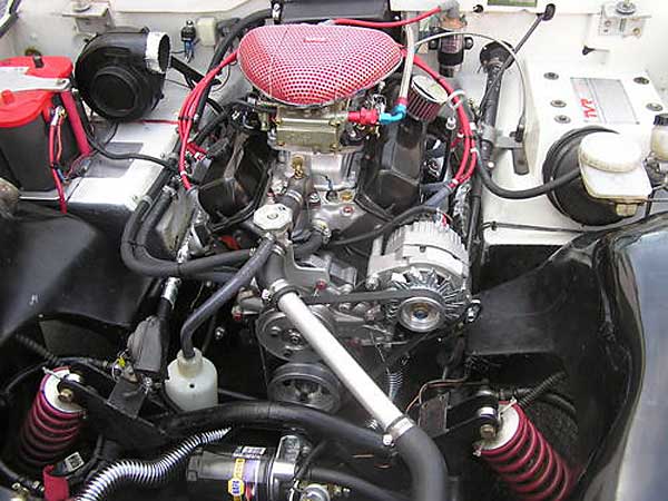

            Cool guys, thanks! It looks like I don't need a tensioner for the belt if I can adjust it with the alternator. At least that is the way it looks here.
              The turnbuckle tensioner/bracket setup from BCC works great.
              You can kinda see it here, I'm using the CCW pump and i have power steering so there are a few more pullies though.
