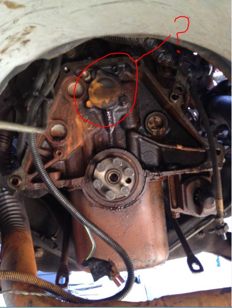

    So here is the run down.
    Vehicle: 1993 Chevy S10
    Engine: 2.8 V6
    I developed a coolant leak in the back of the motor (bad freeze/expansion plug). During the removal of the plugs I noticed a small oil drip from what I believe is the rear cam seal? not sure.. I removed the plate and the gasket came off sort of.. half is on the cover and half stayed on the motor. I need help identifying exactly what it is and if anyone knows the part number so I can order one.. I asked around searched parts catalogs but came up empty.. any ideas? Picture is below (click to enlarge).

    Camshaft housing gasket, Right on Rock auto.
    VICTOR REINZ Part # H36978
    $2.37
