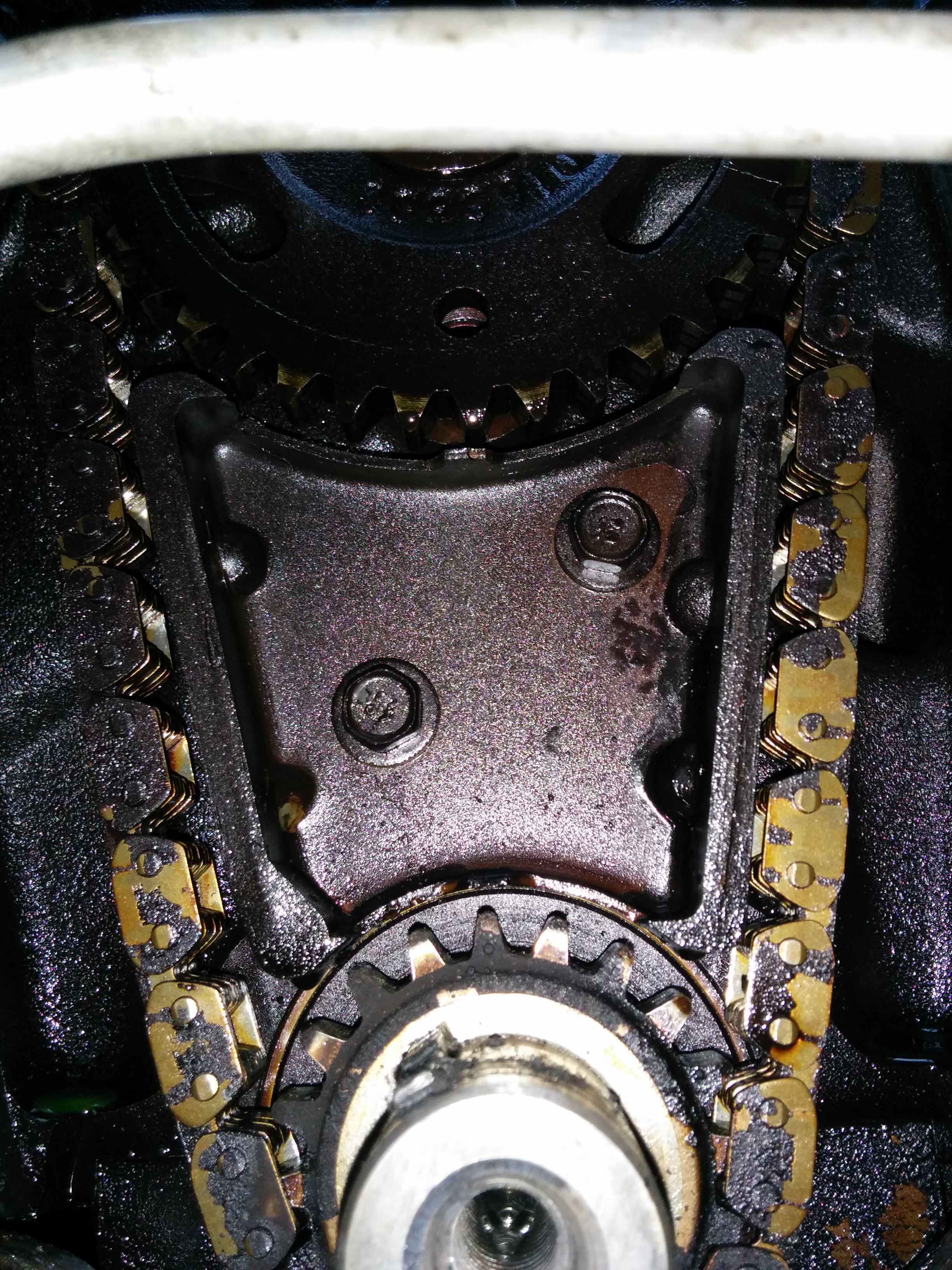

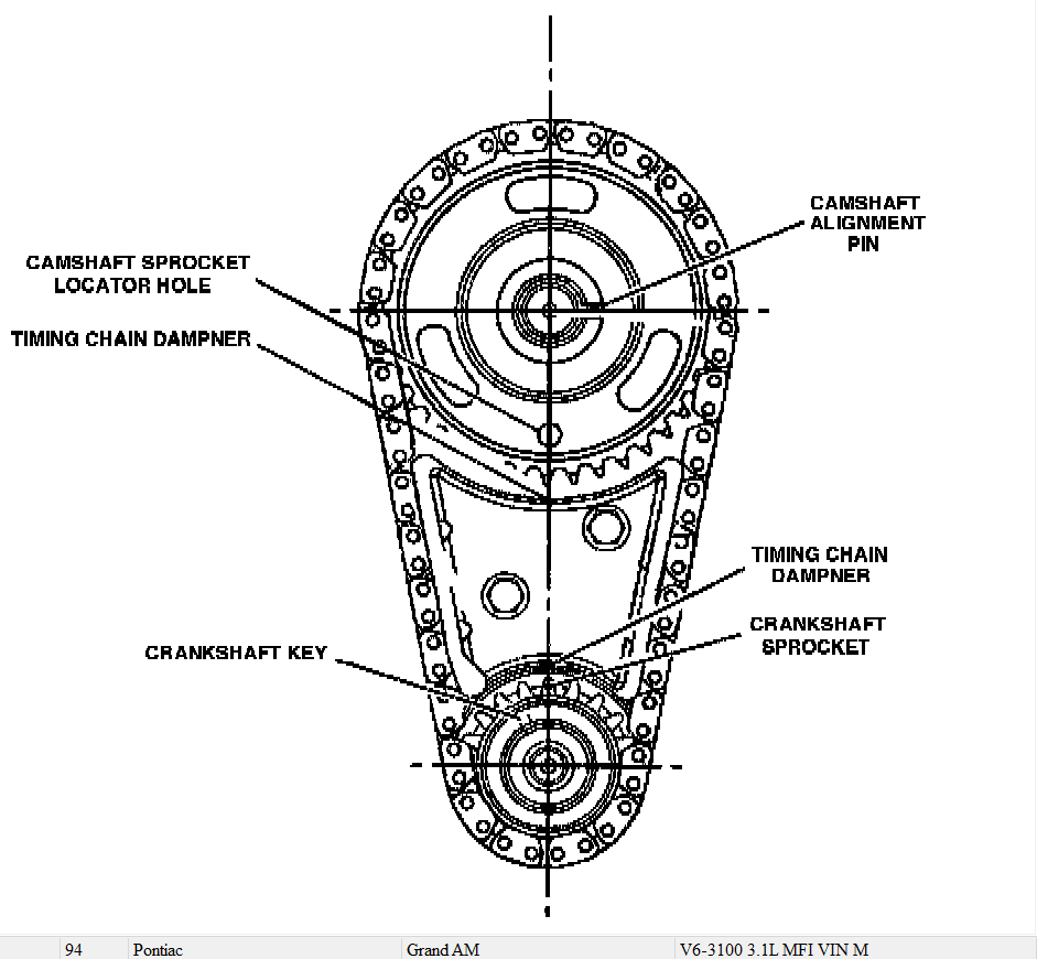

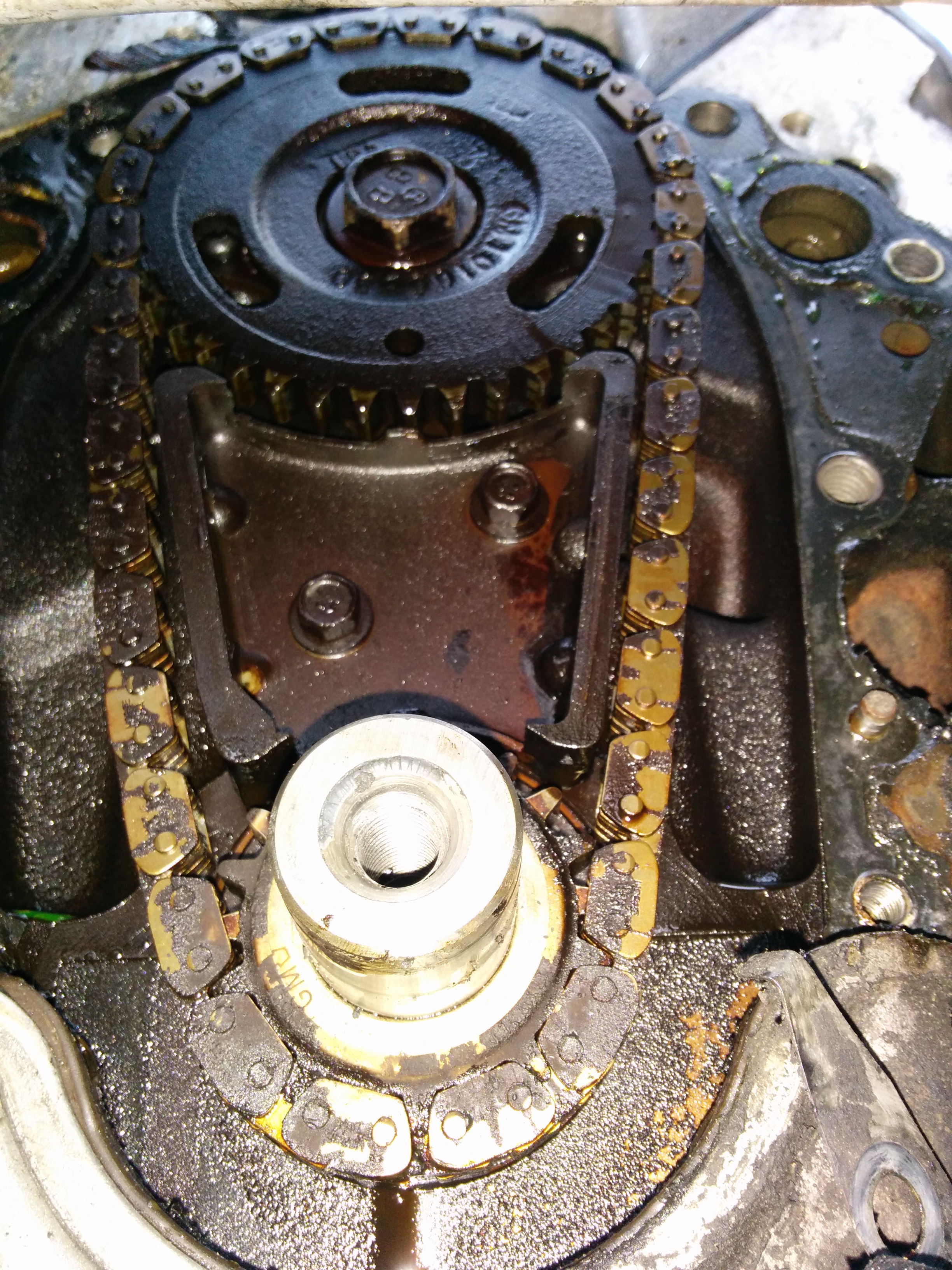

          I have just pulled the timing cover off, what a b*tch that was.
          I am inspecting the chain and want to determine if it has skipped a tooth, however what the Haynes manual is telling me is different from what AllData is telling me. Can someone tell me if this looks correct?
          From AllData:

          On my vehicle:
Name:	timing chain 2.jpg
ID:	377976Click image for larger version
Name:	timing chain 1.jpg
          • Heartbeat1991
            • Mar 2013
            • 68
            It looks right. It has to be a huge vacuum leak or no fuel.
