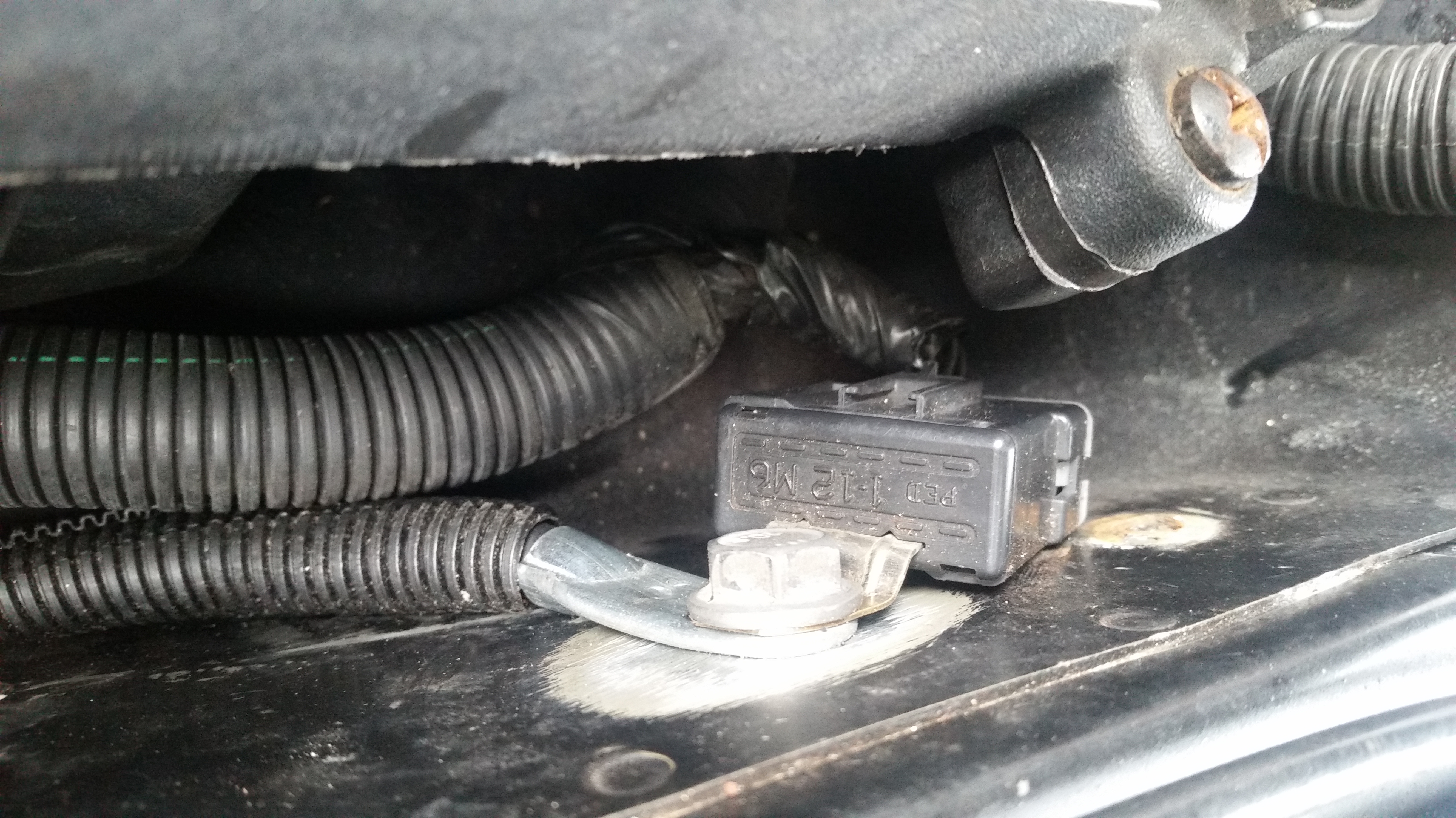

      Just got it figured out. It turned out to be some little module bolted to the transmission housing that was never tightened and kept losing ground. It seems to supply ground for the icm, computer, and not sure what else. I had a transmission put in by Amocco about a year and a half ago. Today I finally discover that they were nice enough to leave every bracket, bolt, and ground nut just hand tight. Transaxle brackets, ABS module, you name it and the bolt was just sitting in it hand tightened a bit. My first time in 15 yrs breaking down and going back to a mechanic and it cost me $2000 and a week of troubleshooting. Apparently $2000 only gets the car half assembled at these places.

        Where was this module on the trans?
          I called it a module but it's really just a ground junction. It's located on the tranny stud right behind the shift cable bracket where the cable connects to the trans linkage. You can't really see it unless you remove the bottom part of the air intake filter housing cause it's hidden under the exhaust manifold pipe that runs along the side of the engine there. It's a little black plastic square thing with a bunch of wires coming out of it, and on top of it there's a metal ring that mounts to the stud and provides ground for all those wires.

            Thank you. I'll have to look at mine!
              No problem. If it helps, here's another one that was mounted up on top next to the air filter where I could easily get a picture of it.

                That does help! I have to find it on my car(no time yet) and the GF's car(it's the one having problems).
