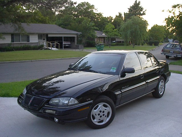

    Hello everyone I just wanted to run this by you and get your opinions. I have a 1995 Pontiac Grand Am with the 3100 with 173,000 miles and I am getting ready to do the 3400 swap ,but after looking in the forums on this site I see that their are lots of different combinations like 3400's with a 3500 top end or a 3400 with a 3500 crank. So I guess in a nutshell I'm just trying get the most bang for my buck any suggestions?
    Thank you, Corey
