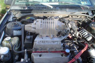

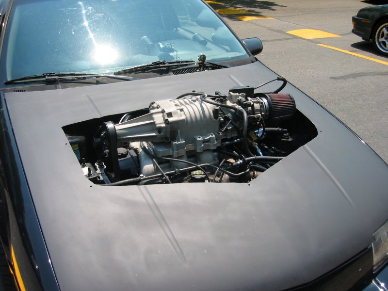

            Haha, yeah, right... Have you ever actually seen an m90 sticking through the hood of a Beretta? You can't buy a cowl hood big enough to clearance the sc. You'll end up with a 10" tall sheetmetal box sitting over a hole cut in your hood. Goodluck with that.
            And what are you talking about procharger for? These are still roots style blowers, an M90 is an M90 no matter how you configure it to work. Just the Ford M90 is configured a bit more user friendly for mounting, unless you want to have it sticking through your hood sideways like a dbag.

              Ok lets get this straight. You can buy a cowl induction hood for a beretta, i was looking at them. the 3800 supercharger is not even 10" tall its self. so its not going to be 10" out of the hood if the engine fits under the hood now, and im pretty sure it does. it will be fine. i post my new 1/4 mile times when its done.
              The first pic is a 2.8 the second is a 3400. the sc on the 3400 sticks up more than the one on the 2.8
