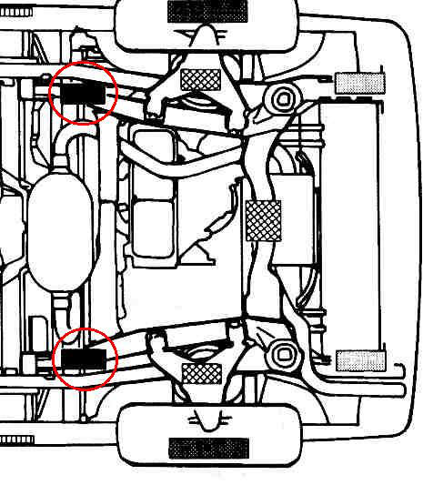

    I am designing full length headers for my 2.8/2.9 Fiero. Some day it will get a 3.4 block with all the current stuff transferred over.
    I've received some really good advice so far, and this is what I've kind of decided on to date. Thanks to XLR8ing.
    3/8's in. Flanges from betterthanyou.
    1&1/2" pipe (stainless if I can get it)
    36" primary length
    Short collector (due to space) into 2&1/2" pipe
    Maybe a collector box instead of a collector, not sure about space yet.
    total pipe length flange to muffler is about 6' on passenger side and 8' on driver side.
    Magnaflow muffler.
    system total length to tip on passenger side, about 9', on driver side about 11'.
    You can get an idea of the engine layout from the attachment. The right bank exits in front and wraps around the passenger side to go out the back. (The CAT is out for now because I'm outside etest requirements.) Not ideal for a balanced system.
    Somebody suggested smaller diameter pipe for a naturally aspirated v6. Not sure about that one. Anybody have any advice?
