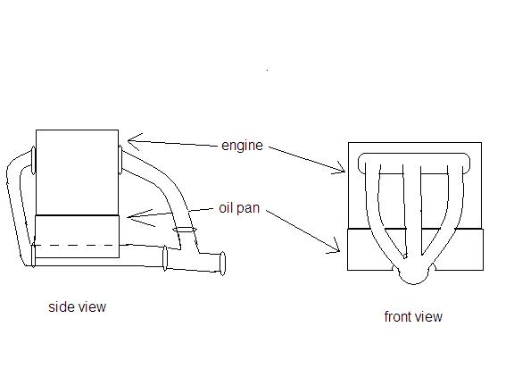

    Ok, so i searched and didn't come up with much in the first 3 pages. I have been looking for pics of custom headers and ideas.
    I have also read a bunch of crap including the two article in engine tech on headers.
    Basically, i need some help with ideas and also on the primary length including the formula listed in the header article on this site.
    This is a very rough pic i sketched in paint. If I am going to have custom headers I might as well have a custom oil pan so I can have a better setup......
    thoughts, ideas, input, help?

        yes but if i was going to do that I would have kept my TOGs, don't you think the design I have drawn will be much easier to make equal length primaries and flow better? Not to mention no headaches so many bends around and over the tranny......
        definately have to think about the dry sump system.......

          What the book says
          I've been doing alot of reading. The only thing to question on your design IMHO, is the runner length. I am given to understand you want not less than 22 " on the primaries and ideally 34-36" into a 2.5" secondary.
          Other than that, the design makes alot of sense.

            what are your number for length based off of? I am looking at 1 3/4" primaries into a 3" secondary......

              What I learned
              I have a couple of sources. I have questioned XLR8ING, who has built up a pretty impressive knowledge. He has designed a killer twin throttle body intake. I've been talking to alot of other pretty knowledgable rodders as well. Everybody has steered me to maximum 1.5" pipe. Some even contend 1&3/8" is even better.
              I also have a book entitled Scientific Design of Exhaust & Intake Systems by Philip Smith and John Morrison. They did engine research in Britain.
              The 1&3/4 pipe is just a little too fat for the size of our engines. The 34-36 in. length is pretty much the standard for full length headers for the V6's to gain resonance.

                Why not just do like the 3500 and route the front under and to the side where the oil pan is already notched?

                      Pics of the manifold doesn't really matter. The fact remains, just look at any 3x00 oil pan and you can see in the front (left side) where there is a bump up in depth. As long as your chassis has clearances in this area, I'd try and run the exhaust in that area.
                        the 3500 pan isn't notched any more than the 3400 pan is...
                        running the primaries under the pan opens yourself up for a world of hurt.. that thin tubing can't take much abuse. you hit a rock, deep pot hole or anything that can make contact and you'll be redoing them.

                          I'll have plenty of room with my custom dry sump oil pan and if needed for safety I will have a skidplate welded up to protect them.........

                              Well, if you are doing a custom pan, then do it whatever way you want. I was just going off of if you would be using the stock pan.
