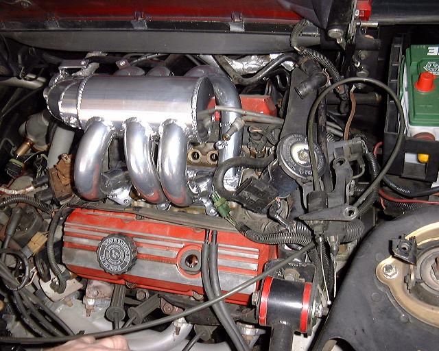

    What aftermarket intakes are there for the2.8 besides the Truelo. I got a stock MPFI 2.8 and looking for some mods.

    whoa that's one wicked intake

      they also have headers

        Got headers and I've seen that intake. Any other aftermarket intake besides that one.

          What hood will that thing fit under?

            the trueleo intake was designed for the fiero, and it will clear the hood of an f-body. i enquired about measurments, but never got an aswer back, they just told me it wont clear the hood on any fwd.

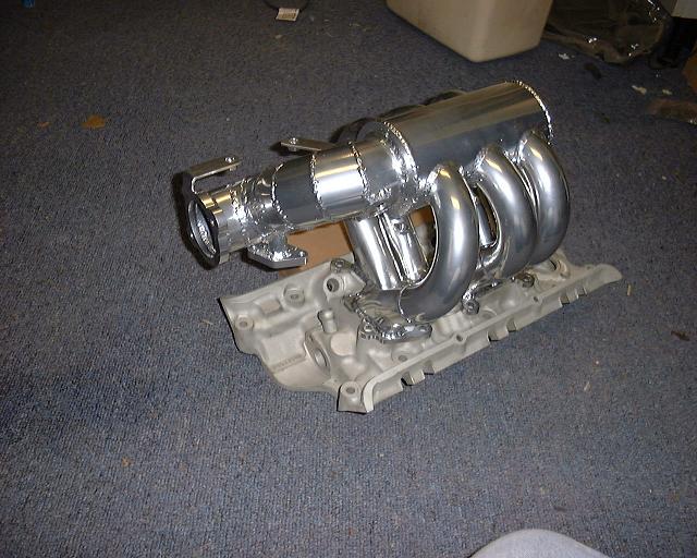

                    • megafreakindeth
                      • Feb 2007
                      • 22
                      west coast fiero sells one that sort of looks stock and costs about 200 dollars more than the trueleo. i got the trueleo intake and its a nice design and really takes the boring out of the stock 2.8. its got air horns inside the main chamber and the throttle response/powerband is excellent, despite the low hp numbers of the engine. took a while to get though, gonna get their headers once i finish deciding what im going to my engine.

                      • Arns85GT
                        • Feb 2004
                        • 140
                        All the Fiero intakes are the same specs.
                        Essentially the only really good options are Trueleo or converting to the Holley/Edelbrock carb system. The Trueleo is an easier mod. The carb conversion is rather challenging.

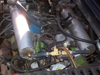

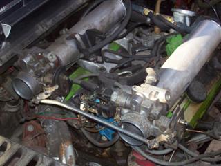

                          • fivepointhustla
                            I prefer fast & reliable
                            • May 2004
                            • 181
                            This intake cost me less than $150...is it pretty? hell no...do I care about pretty? hell no...does it performance well? HELL YEAH. I need to get some more up to date pics I now have dual port nitrous on it.

                            • Arns85GT
                              • Feb 2004
                              • 140
                              really cool if you have the skills
                              That dual throttle body intake is very cool if you have the skills to fabricate.
                              Are you building them for other guys or do you have plans to share?
