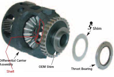

                          here is the shaft he was talking about
                          the shaft connects two gears that go between the others. its a diff.... anyway it has a washer between the gear and the shaft in wich when doing a burnout it slides on. therefore it gets hot, freezes up then snaps.

                            I don't think thats the shaft he is referring to... because every and all diffs have that same shaft... so they would all have this issue.
                            Aparently you didn't read my sig, I think I know what a diff is, since well I built my own transmission, changed it to 3.33 gears, and a LSD...
                            I know diff failure first hand.

                            There must be something else those 4t65e guys were trying to figure out, and I think its the Final Drive input shaft.
