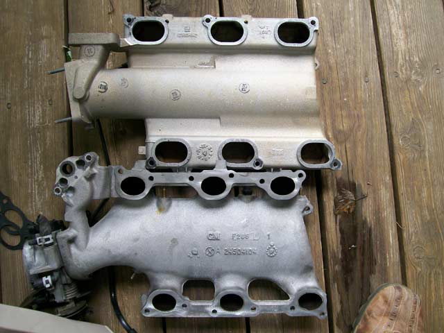

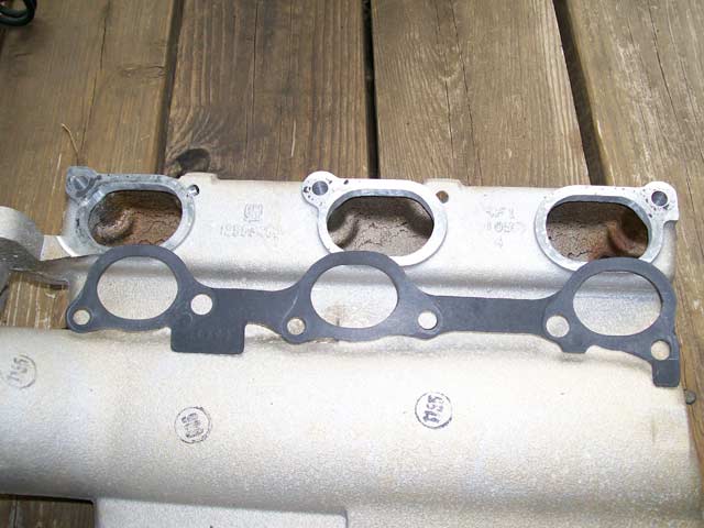

First off we have my old 3100 manifolds vs my ported (by meee!) 3500 manifolds. Huge difference!

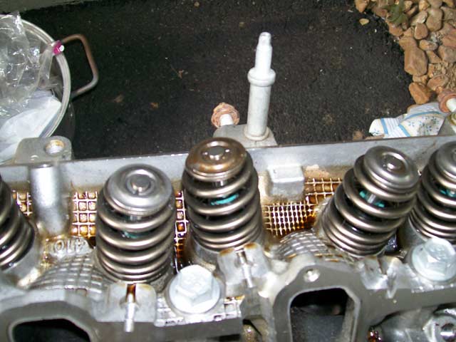

Then I have a picture of some springs. I got all of my new compcams springs on, however a few things shot off on some springs (damn you superdave for cursing me
) so we had to grab a retainer and 2 keepers off the 3100 I pulled out. Visually I could see no difference so I went ahead and used them. This should be OK, right?

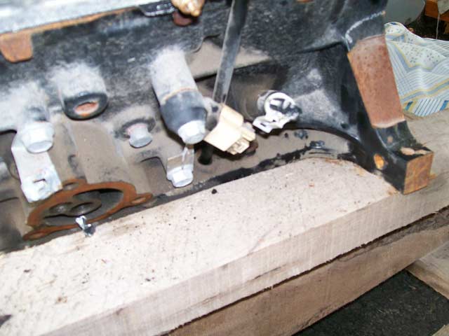

And finally I have a pic of 2 sensors on the front of the 3500. On the 3100 a knock sensor and oil pressure sensor are here, so I will assume these are the same things. However neither of them are no where near compatible with the old harness, nor does it look like I can swap in my old sensors. What is to be done about this?
Also the coolant temp sensor in my head is a 2 wire sensor, when I thought it was going to be a 3. What should I do about this... just get a 3 wire sensor and put it in there, get a connector from a TPS sensor off a junk car and wire it up?SpudFiles

not sure about the sensors. I hae not seen the 3500 sensor. I did take a pic of the cut bracket I had on my 1988 Cutlass for the passenger torque strut. By using this, I cracked one of my mounting bosses. I do NOT recommend doing this.
